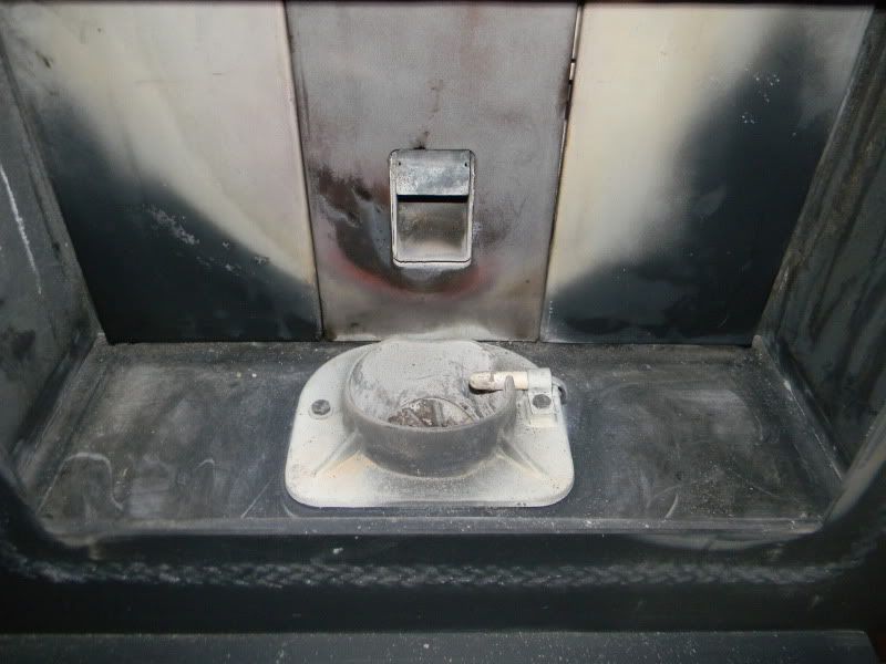

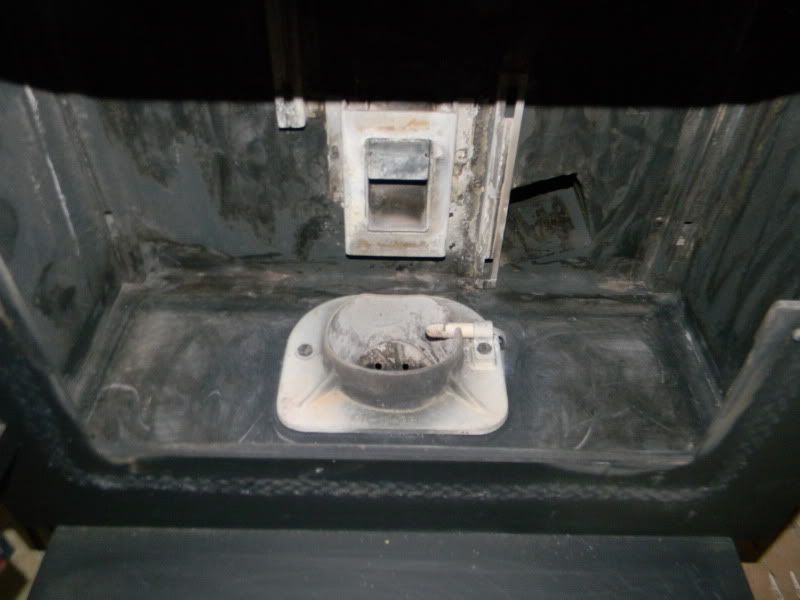

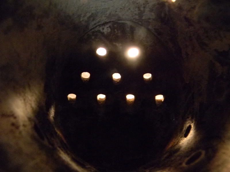

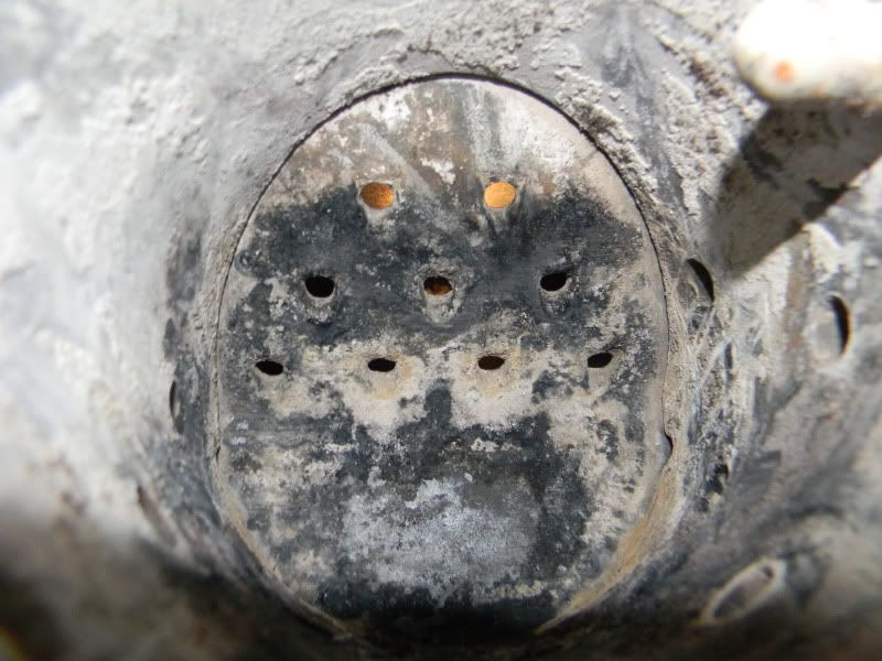

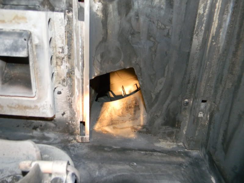

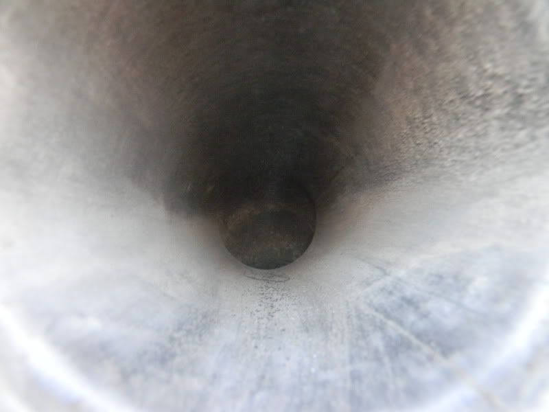

    Pictures of today's cleaning. I never thought to do before pictures. I also think I cured my problem.
    [​IMG]
    [​IMG]
    [​IMG]
    [​IMG]
    [​IMG]
    [​IMG]

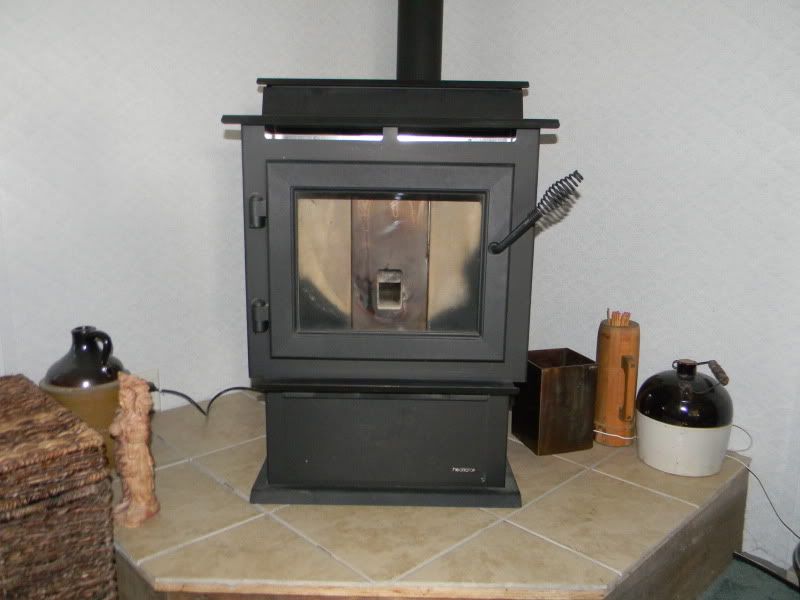

    Pipe outside of the house.
    [​IMG]
    Video to follow.

    The horizontal pipe that goes through the wall of the house gets cleaned about once a month. I guess it was the one thing that I forgot to do this spring when I cleaned the stove out after the heating season was finished. It was about 1/3 full of fine ash right after the 90 before it goes outside. The feed gate is now back open to were it has always been and the flame acts like it always has. Only issue to figure out now is why it is still randomly shutting off before desired room temp is met or even sometimes not even starting after the T-stat calls for head. It has done that since the second day it was in operation.
