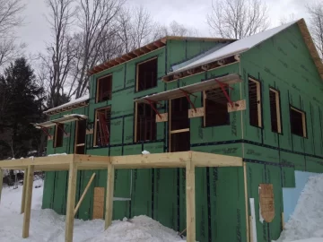

fox9988 - our lower level is a walkout lower level, nothing below it but a finished level, the total sq ft is 2200 between upper & lower levels - pic is from back of house but stove will be along the narrow wall on the upper level

My last house is very similar to your photo, and I was able to heat all of it with the Quad Isle Royale. You will not get any of the stove heat from the upper level into
the lower level. How will you be heating the lower level?
Hi Northwinds :) - We will have radiant floor heating (propane) on both the lower & upper levels, on zone control, will have slate/tile & wood (likely bamboo) flooring
Sounds great. pretty home.

Nice house. Where is the walkout door from the basement?
Edit: I think I see it, behind the plywood with a 2x4 brace.
Propane is pretty expensive fuel. If lots of wood is available at a reasonable price then I would at least consider putting the stove on the lower level and going up a size to the Fireview. How does the lower level connect with the upper level? Big wide open stairway, or a conventional 3ft door at the top of a 3 ft stair? How thick are the walls? 6" or 4"?
Thanks again to all, such a nice community :) our lower level is open to above, begreen, but the time to switch to Woodstove below has passed, also, want the ambience of the wood fire in our main (upper) living area.

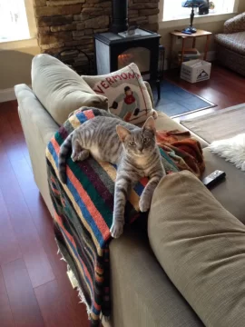

[Hearth.com] Thoughts about the Quadrafire "Yosemite"
Our Keystone in our new home, moved in this past June, we love our home & the stove! So easy to use & keeps us really warm!!

The cat is pretty nice too. ;)
Reactions: VTPharmgirl
Beautiful, all around.
