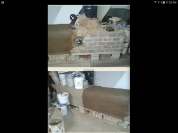

Please clarify. How is the Rocket Mass Heater i built, Not a Rocket Mass Heater ?

So the barrel isn't metal? The piping buried in the mass isn't metal?
Ya got me on that one :)
I was referring to the all steel J tube designs, that would not last under intense heat.
You have a burn barrel in brick
And "A properly built Rocket Mass Heater has no metal parts in it. The fire box is made from fire brick, not metal."
You're criticizing me now on following YOUR definitions? Interesting way of dealing with comments.
See the above comment, i admitted my error.

What are your clearances to combustibles ?
Not enough. At the back, it has a concrete board heat shield with 2 inch air space, about 24 inches from the barrel, too the right it has about 5 feet from the wall to the barrel.
This RMH was dismantled when i moved the shed too make room for the new house - it is no longer there - since it weighted 3 or 4 ton.
This is why i am on here, when i build a RMH in the new home, i would like to do it properly.
That is more, and simply, a masonry heater. Also know as a "Russian Stove" in Europe (where there are thousands not only still in use, but being built new all the time in Europe). You can Google this term and see images with simply searching for "masonry heater".
So the general "Rocket Mass Heater" concept is not new. It is ancient. The RMH crowd will claim they invented new methods that make it better.... but no, they really have not. Don't waste time arguing with them. In fact, I think some RMH are less efficient, as the European models you simply load up with wood (huge firebox), touch if off and walk away. There is no need to constantly feed wood through a small hole in some RMH models I have seen. Human time spent is also a measure of efficiency.
Side note: The original designs for the RMH I saw were indeed different from the European models and often included a steel drum as part of the system. You can Google for images by using "Rocket Mass Heater steel drum".
These stove are designed to burn fast and hot and store the heat in a mass heat sink the flue gasses pass through (some use masonry, others use mud and plant material to form the thermal heat sink). And then that mass releases that heat over time slowly. But that is slow radiant heat only.
So how efficient these stoves are at heating a room is dependent on the building containing them. If can vary. I have been in larger building here in Hungary where such a masonry heater was in each room. Because the heat from one simply did not move from room to room. So best only if you have a small space and an open floor plan.
The hype can be intense in the USA. In Europe, there are pretty much standards for construction. So take that for what it is worth to you.
