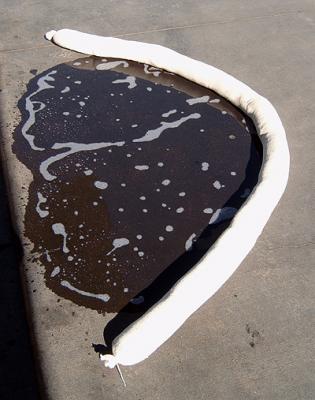

Well there's 4 bolts and they must be in exact locations. Then you have to figure out a way to contain the water and cement slurry.
chemical spill sock would work
