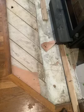

I pulled up the existing floor and reset a border, I’ll remove the angled subfloor in that area and bridge between the joist to support the hy-c floor protector and build up to the height I need with hardibacker. The concrete section is not close to level and some areas need .75” added whats everyone’s preferred self leveler and are there some types to avoid that can’t take the heat? I won’t have the floor protector there.

I would just put thick mud down and tile over the top, its not like there's any big weight on it other then a person or arm full of wood.
