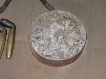

If there are no serious issues, I'm going to guestimate that it may cost about $250-400 to get the old girl up to good burning condition. It'll cost at least 6 to 7 times that to get a new cat stove of decent size. From the description, it sounds like the cat may have died. You can try pickling the cat in a vinegar water mix to see if it can be resurrected to finish the season. (see link below)If not, I'd be tempted to get a new cat now and finish out the season.
This summer, I'd pull the stove into the shop, clean it out and blow it out completely with compressed air. That will help expose seams that need resealing. Give the bypass damper and its linkage assembly a close inspection for too much play or warping of the damper. Then you can decide whether you want to rebuild. If the stove is like many, it may only take removing the nuts on 4 corner threaded rods to pop it apart. With a good, exploded parts diagram, rebuilding a stove is not as hard as it may sound. Once she's back together, she should again operate well for years. If you decide not to tear it apart, you can probably sell it for the price of the combuster.

Thanks for the tips on cleaning the cat and starting the rebuild. THe old cat is half to 3/4 disinergrated into a hundred fragments. After 19 years, I am suprised it lasted that long. Maybe if I followed the vinegar water procedure, instead of running tap water through it, it would have lasted longer. But I am happy it lasted as long as it did. I did notice in the last year or two that its performance was off alittle. Harder to get it to fire at 400 to 500 F. But once firing, it would still get the 2nd combustion up to the 800 to 1,000 F range.

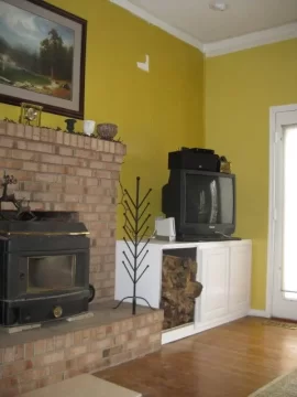

Please post up some pictures of the old girl and the chimney. We love to see those oldies but goodies.

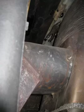

I'll get some pics and post them with another post. Although I can only show the pipe below the block off plate. The pics will show that I only have about five inches of clearance on either side of the stove and about three or four inches above the stove. The stove is about 3/4 out on the hearth, about 1/4 in the fireplace. Those clearances is what makes disassembling and removing everything such a chore. Thanks for the advice. Sean

I tried attaching a couple pics, and I think I got them past the error messages. First too large, then the wrong file type. The stove has a 45o discharge so that the coupling pipe can make it either an horizonal discharge or a vertical discharge depending on how the connection is mounted.
I appreciate the suggestion of using an 8" oval chimney liner. However, I don't think the oval will fit down my 9"x9" chimney. At least, the oval that I have going up through the block off plate and smoke damper plate does not fit up into the 9x9 chimney. So it is either continue to have the pipe go up about 3' and use the chimney, air chisel out the smoke damper to allow for an 8" circular liner, or change to a stove that has a 6" flue so I can get a 6" liner through the smoke damper.
