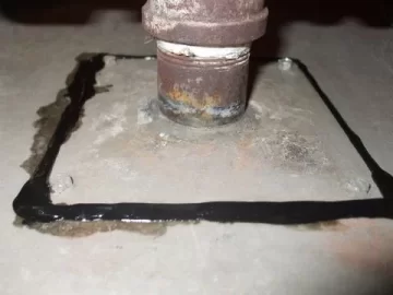

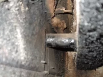

mine just like yours except im at 21'. my father inlaws is at 24' , no huff . my buddies that huffs is at 18 feet with the 4 four feet uninsulated inside. i havent pulled any sealant or tin away from the supply and return of the vessel but i dont have any noticeable corrosion either. im on my thrid year and last year i ran it for my dhw through the summer. i run mine wide open most of the time with hardly any idle time. my buddies homebuilt seton rotted the back panel open at the bottom in one season from to much idle time. so id suspect that he may have issues with his vessel. i wonder if prolonged idling and creostote build up then burning off can contribute to the huff? i plan cleaning the vessel tommorow morning ill take some pics. i havent done it since last year so im curious to see how it looks. last year was the first time i cleaned it and i had some idle time previous to the cleaning. ive run it alot hotter since then to try and keep the vessel clean, we'll see.
i inspected the vessel supply and return of the vessel. the return appears fine from waht i can see of it. the supply has a piece if tin around it that is so tight i couldt slide it up to see underneath without ruining it. so i cleaned it up and resealed it. i took a picture without sealing the supply so you could see what i mean. i dont know if the greenwoods are sealed this tight but maybe seton did this for a reason.

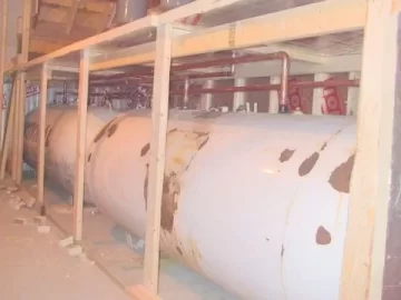

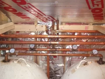

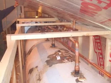

Looks good nice pictures, I need to figure out how to do the storage for my system. I'm sure that all the idle time I went through this season hurt a bunch. Is there any where I can find a simple schematic, or cut away drawing of the storage process? do you have any pictures of your storage setup. I remember you saying that your boiler was 200' from the house, is the storage at the house or near the boiler? How much and what kind of tank? ..............Seems kinda dumb to spend so much time and energy heating 12 gallons of water. Sure did work good though.
jesse said:
2beans

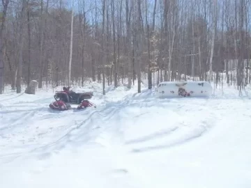

my tanks are 250 feet from my boiler in my basement, i have two five 500 gallon propane tanks hooked in parallel. real simple cold to the bottom and hot off the top. theres plenty of topics on here about storage just look them up and start reading. if i had the room id stack the tanks, but i didnt.
