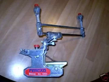

I have one very similar to the Granberg , I got off Ebay, never heard of the brand.
After a little practice it is quite easy to do a good job sharpening.
I really like it.
