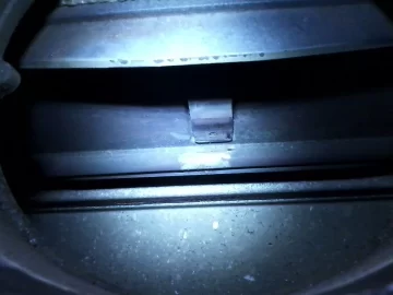

(4) In trying to tighten the damper bar, in the flu collar with the damper close (per manual instructions) I cannot see the damper tightening screw - only from inside the firebox there are two screws. Does yours look like this and which one do you tighten?

on question 4. Look thru the door at your dampner with it closed. You should see a regular looking bolt with a locknut on it. That bolt goes thru and hits a strip of metal on the other side. If you loosen the locknut,,and screw the bolt in,,,it will make the door close tighter. Only move it a little at a time. What you need to feel,,,is the last inch or 2 on the handle as you close the dampner. Do not go crazy tight,,it will just smash the gasket.
If your stove is cold, take the pipe off and look down in it while working the handle. It will be perfectly clear to you then.
