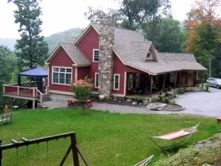

THANKS BE GREEN. I WILL PLAY WITH THE OTHER STUFF IN THE NEAR FUTURE. I HAVE TO GET BACK TO WORK. SUBMISSION IS DUE TOMORROW.......
BTW THE OWB WILL BE JUST OFF THE PIC TO THE RIGHT NEAR THE DRIVEWAY. THE CLIFF IS ALSO RIGHT THERE.

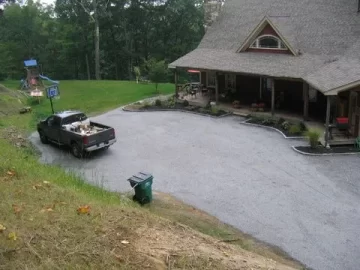

SEE PIC TWO. THIS STUFF IS ADDICTING!!
THE OWB WILL BE BEHIND THE BASKETBALL HOOP.

Great. The house and location look beautiful. Are you in the Catskills? The pictures are coming through fine, but the caps lock key seems to be stuck on.
The way you have described the house I'm not convinced an OWB is the best solution. With SIP panels and good glass it should not be hard to heat. The only big challenge is the exterior wall fireplace. (Old homes always placed the chimney and stove in the center of the house. Is this an option??) If you can post a picture of the floor plan that would help. Otherwise you will have to describe the 1st fl plan in detail.
