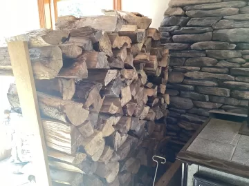

This is wood in my house right now from three winters ago. I don’t know about three years uncovered but I know two years no problem.

This wood was cut last winter. About fifteen months ago. It will go under cover late August or early September after a dry spell. How’s it look?
It looks like wood. The question is what moisture content does it test at vs what would it test if top covered the whole time. In my experience wood dries much faster when rain and snow is kept off of it
I don’t need a meter. I have a Hearthstone Mansfield and an Equinox. Neither will burn wet wood. Two years uncovered and it starts like gasoline on it. You might need a moisture meter but I don’t. I started out covering my wood and only one season and would have moisture in the wood. Full load and I’d be lucky if the stovetop reached 400 degrees. Now with good wood stove goes from cold to 600 degrees no problem.You may need a moisture meter but I don’t. By the way I bought an aftermarket starter for my Kubota tractor for $79 when the Kubota starter was $279. I went on the Kubota forum and twenty people said to only use Kubota parts. The $79 starter has lasted 8 years. It appears I’m a risk taker. Can anyone else on here survive without a moisture meter?
