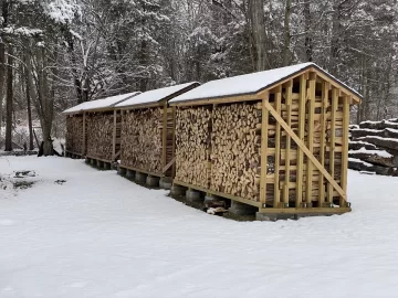

Of course, if this woodburning thing is a long-term plan for you, and not just a passing fad, you're going to want to build a shed. Only with a roof over the wood, and free air flow between roof and wood, will you be getting clean and dry wood to bring indoors and burn.
I'm in CT - def top cover + elevate the bottom so it doesn't touch the ground.
My top covered wood is uniformly dry + super clean.
My wood that's left in a pile has mushrooms growing out of it, worms and beetles crawling underneath bark (which soaked up rain water), and bottom layer is half rotten and sank half inch into ground and now full of crawlies.
Left in a pile only the top of the pile dries. Definitely stack the wood elevated off the ground. The importance of top covering differs with how much rain your area receives. Top covering has pros and cons to it. You have to figure out what works best in your environment. I top cover my wood only during burning season. During summer my wood is left uncovered so it gets the full benefit of the sun and wind.
Exactly. Consider this when building your sheds!
