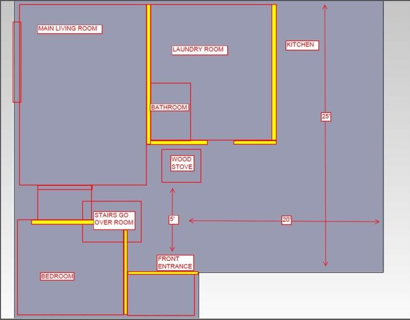

With the high ceilings and his floor plan (a sketch might give a clearer picture,) would you think he'd be better off with a more convective heater like the T6 w/blower?

here is a basic layout of he main floor. I have highlghted the walls with the yellow lines. everything else is open. and remember everywhere in the 'kitchen' area and the 'main entrance' area is a high 15' ceiling....
