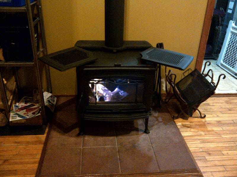

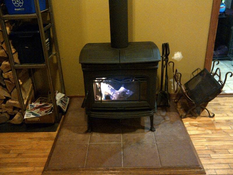

pics of the wood stove up running:
[Hearth.com] To Go SOAPSTONE / or Pacific Energy Alderlea T5 / T6???????????????
Definitely a huge difference - night and day from the little Drolet stove that was there!!! I think with all the clothes that my wife was stripping off my sex life may actually go up!! another selling feature!!
A couple of things that I did notice and question:
1) the window had a fair amount of powder coat over spray on it that does not want to come off.... any ideas???
2) the ash tray does eem to rattle a bit if you have heavy footsteps while walking in front of the stove... but its the ash tray Im fairly certain... (as oppose to the top fold out cast leafs) can be kind of annoying.
3) the bricks supplied with the stove dont appear to be of great quality... for such a high priced item you might think they would be a better stone. Im pretty sure that after a seasons use these light stones will be falling apart.... but time will tell.
As for the weekends results. After some light burning and getting rid of any chemical residue that was left over. little smelly... and it was a warm weekend so it didnt take much to get the house temperature up... But the stove easily climbed to a reeading of over 450C - 500C it actually baried the thermometer which topped out around 500C and that was reading with a thermometer on the top cast iron with the leafs folded out and the thermometer placed on the lower cast on the stove top.
Overall the stove looks great. We love the ook of the heavy cast Iron and the feel of the heat output is definitely different than the Steel Stove that we had in the house. and you can feel the warmth move much better through teh house with the bigger heat source.
Congratulations, it looks great. I'm disappointed and surprised to hear about any overspray on the glass, the stove should have been painted before the glass was installed. Ask your dealer about this. The glass may need to be replaced.
Not sure about the ash pan rattle, make sure it is pushed back all the way home. Ours is quite solid. The bricks are actually made of pumice and are premium, not cheap bricks. They use pumice for it's higher insulation value to achieve a hotter, cleaner burn. They will last years as long as you take care of them. Don't slam in the wood and they will be fine. Ours are going on year 4 and still looking good, no cracks.
The stove box itself is steel. It sounds like you are running it too hot. The normal top temperature should not be run above 400C for a long period of time. 500C is in overfire territory. For comparison we are running our stovetop between 300-350°C. Try cutting down the air earlier and not reloading on a full hot coal bed. Our thermometer is placed to the front and left of the flue collar, so that it is visible with the trivet top closed, through the slats in the trivet.
I have contacted the vendor about the overspray on the glass. I wouldnt care too much if it was minimal but its a fair bit... so Iam going to see if they can replace it. Unfortunately on pickup it was all wrapped up and I didnt think to check anything like that....
I though the bricks being less dense would be a less insulated material? A friend of mine purchased a Pacific Energy Vista stove and received the same bricks on purchase and his fell apart. BUt it could be possible that he was running the stove to hot??
As for teh temps I saw - I was surprised to see those temps and was just a cause of not turning the stove down and was unintentional.
As far as over fire territory goes... what exactly does that imply?
The stove is built like a tank, but frequent overfiring will eventually stress out the joints and welds. Evidence of overfiring can void the warranty. For the longevity of any stove you want to avoid prolonged or repeated overfiring.

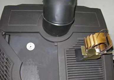

For reference, here's our thermometer location.

I never actually thought you could get the temps high enough to stress the steel welds... I mean the melting temps of steel being close to 2600F and the internal fire burning temps at what 1000F? does it get much hotter than that? I guess it will in that case... good point then.
As for the location of our stove thermometer I had it placed more centrally located but same general area - I notice that yours IS closer to the stove pipe..

My o my, looks like someone spilled something on the top, tisk tisk

what is that - placed on the right side of the top of the stove? the brass looking contraption....?
Top view of an EcoFan. It's actually spinning, but the flash stops the action.
