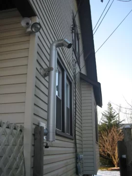

but most pellet exhaust can go straight out a foot or so like a dryer vent..
to go up like this install, it helps to get rid of smoke that would fill up your stove if there was a sudden loss of power and stove stopped running.? sorry for multiple pixs..

Correct me if I am wrong,?
View attachment 120589 View attachment 120589 View attachment 120589
the reason for a vertical rise is to increase the natural "draw" of the venting (chimney). This will help to remove smoke in case of a power failure, and in my opinion a minimum 3' rise (4' better) is always a good idea. What we CAN do and what we SHOULD do are so often different... Hope that answers your question.
