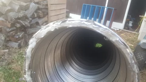

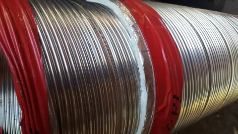

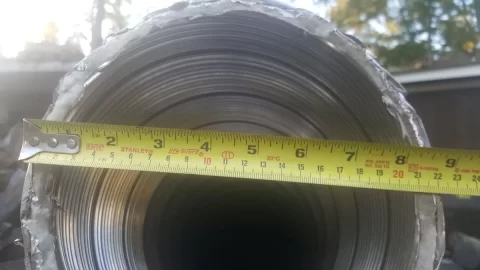

I'm not trying to argue with nobody cause clearly I've only installed 1 liner but I'm just showing the one I got and the insulation adds an inch. I held the tape too high

Did you order your liner with 1/2" or 1/4" insulation? Because that sure seems like 1/4"
1/2 " insulation I don't need the guide, seeing is believing
Redyute, My O.D. clay tile is 8 inches which make the interior less than 7 and your picture sure looks like your liner is just shy of 9!! That wont fit unless I am missing something.. And Bholler, I have read your responses often and I agree with your logic but just how do I get to that rebar as its pretty far up the flue and cant be reached by hand. I am 6 foot 3 with long arms but no way can I reach it to cut.
its an 8" liner I'm not using a 6" lol. I don't know i was just sharing from my experience with the liner cause i thought an extra 1.25 - 1.5" for insulation was off that's all

its an 8" liner
Yes I understand that but 8" forever flex is 8.25" outside. then you have 1/2" insulation so you are at 9.25 plus the thickness of the outer liner. You are showing an outside measurement of about 9" so Idont see how you could have 1/2" insulation there. I am not trying to criticize you but I work with this stuff every day and I dont want someone to be misled with inaccurate info.
