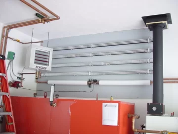

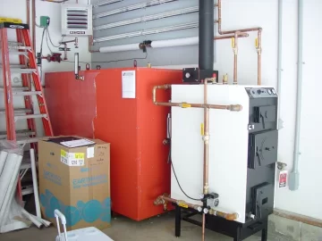

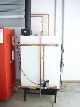

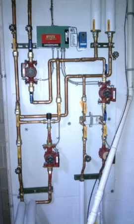

I have a Varmabaronen Vedolux 37 installed and used it all last winter. It is connected to the 500 gallon tank sold by Smokelessheat.com for a total of 536 gallons. Ran 1 1/4" copper all the way from the 2-car garage into the basement to panel. Have water tempered to 140 into heat exchanger on furnace. Keep water heater at 115 degrees because sensor is 1/3 of the way up and it can heat the entire tank in about 6 minutes.
I have learned so much since it was installed- 6 months of research doesn't compare to 1 month of using it.
Since I've had it installed and used it, I am going to put in my 2 cents here for all of you. I hope it helps you all come to a decision. First of all, the boiler is a high quality product. I compare it only to other products that obviously have quality built into them. In other words, I can't compare it to a Tarm or any other boiler, only that is looks, feels and acts like a high quality product.
For the first month or so last winter I was firing it 1 time per day trying to heat the tank to 220 or 230 degrees and get through 24 hrs.. This presents several problems I discovered, only by deciding to try and fire it 2x a day- once every 12 hours and BAM!- I fell in love with it.
You see, you'll never get over the laws of thermal dynamics: The hotter one item is when next to a cooler item (the room the boiler is in), the faster the heat loss takes place. Take a simple glass and pour 180 degree water into it while in a 70 degree room. The heat loss will be much faster than if you pour in 140 degree water. This was my thinking when I started to fire it 2x a day. Just fire it to 180 and call it a day. That evening- just fire it to 180 and call it a day. This way your heat loss through fittings and exposed areas is less. And, you aren't sitting there baby-sitting it putting in more wood to get it to 220 or 230 degrees. Anywhere from 1/2 to a full load (depending on the heat-loss that day) and your're done- walk away. In the 40's I put in about 6 pieces and in the 20's about 10-12, light it in 30 seconds, shut the door and DONE! I clean the ashes out each night (don't even clean it in the morning- just throw in six pieces, light it and that's it).
I light it through the main loading door. Put a tight radius piece of wood in the center so it leaves a gap on each side of the suction hole in the ceramic grate. Then a straight piece of wood on the left and the right up against the middle piece of wood so there's hopefully no gaps. Then I take a handful of pine shavings mixed 50/50 with shredded paper from the paper shredder and fluff it on top, place a small piece of cardboard (4" x 8") on top of that. Push the start button which turns on the suction fan, hold the torch on it for about 15-20 seconds and shut the main door WITH THE LATCH IN THE WAY so the fire is getting air from the top through the main loading door. After about 1/2 to 1 minute you'll know it's firing by opening the bottom draught hatch and see the yellow flame. I start adding wood and shut the door all the way. I would say it takes me 10 min. in the morning and 10 min. in the evening.
I do the heat exchager tube cleaning with the brush every 3 days and use a wet/dry vac to get the ashes out of the top.
That's it! Hope you enjoy the install pics!
If anyone wants to know anything else about it just ask!

I've got a quick, and hopefully not a dumb one - I don't see an aquastat or temp probe in the top of the boiler, so wondering how the over heat/dump zone is controlled? And what do you have for back up heat?

Think the valve on bottom pipe is a NC for overtemp.

I saw that valve there. But overtemp valves are usually NO ones, and they usually get a signal from the top of the boiler that kills power to them and causes them to open. Just didn't see any wires or anything from the top of the boiler.

The dump zone has an electric solenoid. As long as there is power, the valve and flow to the dump zone is closed off. As soon as the power drops the solenoid releases and opens the valve and flow to the dump zone.

OK - so I guess that means your dump zone is set up only to handle excess heat in a power outage. It isn't set up to handle excess heat if your system/tanks overheat when things are cooking under power? Or is it tied to a circuit that shuts the fan off in an overheat?
Maple, FYI my dump zone is the same setup, for power outage only. I have a make-on-rise aquastat that I plumbed into one of the fittings on the top of the boiler. When that gets too hot, it kicks on one of the zones in the house. That pulls the heat out of the boiler, and lets me know there is a problem at the same time. We are keeping our house pretty cold due to how drafty it is (keeps down the wood consumption), but if Im going to just dump heat somewhere, might as well use my house as the dump zone!
Automag valve is for power loss, since then my other dump zone idea wont work so well....

Such a nice looking and compact install, coldfeet. The vertical flue neck and side-entry supply and return ports on the Varm really worked out.
