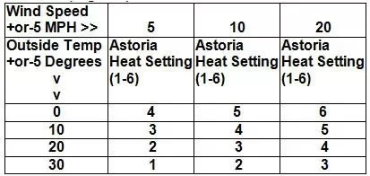

Hello
My basement Avalon Astoria install heats our 2k sqft split. To heat it right on a cold night like this I developed this chart.
Right now it is 11 Degrees F outside!! Looks like with 20 MPH winds my heat setting should be 5 out of 6 Wow but that will be COMFY!! LOL
The following chart is a guide for heating the whole house (Split Entry) with the stove installed in the center of the basement with 2 registers with a convection fan and a doorway fan in the doorway to the basement.
Pellet Stove Heat Setting, with the Air Restrictor on 2 and the Convection Fan on 6 (Highest)
Outside_Wind
Temp___Speed
+or-5__+ or - 5
DegF___MPH
v v___5__10_20
0_____4__5__6___Astoria
10____3__4__5___Heat
20____2__3__4___Settings
30____1__2__3___(1-6)
Example1: Early Saturday morning on 01-30-2010, The wind speed was 20 MPH and outside temperature was 4 degrees. the chart says 6 for the heat setting. At that time, we had it set to 5 when we were asleep and 6 when we woke up for more warmth and comfort!!
Example2: 02-07-2010 at 2 pm, the temperature was 27 degrees F, and the Wind Speed was 9 MPH. Therefore, the chart above puts the heat setting between 3 and 2 (slightly closer to 2) We have it set to 3 for comfort although 2 would be adaquate!!
So guys what is your heat setting and how do you know?
