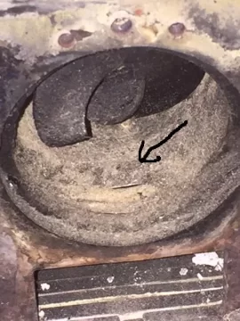

Maybe another harman accentra question? My stove has a smokey smell. I have replaced and I have had the dealer replace the exhaust pipes, observe it, reseal exhaust. I'm pretty sure the exhaust has been taken care of.
The smell is still there. I have checked and taped windows, anything I can think of. I have replaced the door seal and looked at the others. I don't see any smoke, but I smell it.
Dealer says the heat exchanger can't leak to room because of the negative pressure caused by cumbustion fan. I understand this general concept but is that too broad a staement? We are missing something. Have you seen anything like this? Any ideas to try? thanks much!
Check your auger tube for a hole like this.

I see, it is a gap, I'll check for that once I clean it good. Did you get a smoke smell from this leak? Very interested to hear
Usually it will cause to much air to enter the unit and this will cause creosote to form. Some people don't get a smell and some do.
