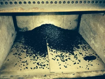

So I decided that since the weather broke, I would go up and clean my flues today. Well that turned out to be mistake. There was still snow and ice at the edge of my roof which made getting on and off the ladder way too dangerous. Won't ever do that again.
Anyways, I had the top taken off of my multi-flue cap and was getting ready to start the sweeping before I nixed the idea. I have my brush attached to ropes so I have to pull the brush down from below, and then back up from the top. Before I closed everything back up, I took the wrench I had with and banged it around in the top of the flue to knock some of the loose stuff down. I was unpleasantly surprised to see how much creosote came down the flue just from that.
So my question is, is it too much for not even having run the brush down yet? This is about a 20' flex liner. We've been burning pretty much 24/7 this season whenever the temps are below freezing. There wasn't this much creosote last year when I cleaned in the spring.
I've been wondering if we had been burning too low. Also worth mentioning the last load of wood I brought up was kinda wet. Split it and it measured ok, but the bark was wet and so was the wood right under the bark.

That is the dictionary definition of a mess. Since you had the cap off anyway why didn't you at least drop the rope and drag the thing down into the firebox with out the pull back up to the top?
If that just came from banging the top, pull the baffle, get a mirror and flashlight and angle the mirror to get a look up from the bottom.
Subjectively that seems like a lot (did you put it in a container? gallon bucket, coffee can ect? to quantify it?), and it looks kind of shiny rather than a dull gray color ... I'd want to sweep that liner... but I would also want to be careful and not fall off the roof too! be careful.

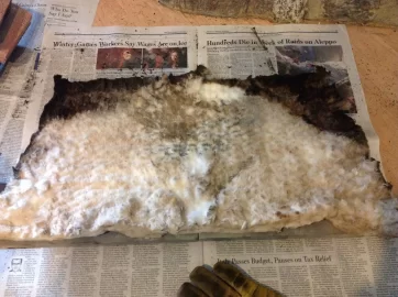

I went up as well today since it was beautiful out. Finally a chance to sweep for the first time since owning the stove. It was installed December 2012 and I would say that maybe 1 1/2 to 2 cords had gone through it so far. I purchased a sooteater and ran it down from the top. I also got that fine flaky shiny stuff and did not get all of it as it it a flex liner and ribbed. I would say I got close to half a gallon of it and it is a 21 foot high flue.
Considered normal? Good? Bad? Also please tell me if this is normal wear and tear for the ceramic blanket after this amount of time.

1/2 gallon of shiny stuff sounds like a lot for 2 cords,even if you swept! Is the liner insulated? I stuffed roxul around the top 6' of mine and saw a marked improvement in my cleaning today. Hard to get all of it in a ribbed liner, but that's ok. Good luck and welcome, these guys will get ya fixed up right.
No not insulated. Just plain old flex liner run up inside of chimney.

Get 'er insulated- keeps the flue gasses hotter = less creosote. Knowing the stove is operating at the right temp is crucial also. I burned mine way to cool my first year. Also had fresh wood. My flue looked like the la brea tar pits. Once you get a few years ahead on wood, everything gets better. What is your wood supply like? It's the biggest factor in having a clean flue, efficiency, and SAFETY.
I usually get some crusty shiny 'sote just in the top four or five inches below and where the liner collar is over the top plate. This year I did something I have intended to try for years. Rolled some fiberglass insulation in aluminum foil and wrapped it around that collar with aluminum tape a couple of months ago.
Went up yesterday after most of the snow was off of the roof and found no crusty crap at the top of the liner. And a heck of a lot less flaky stuff laying on the top plate from falling off of the cap. Cap was glazed but no flakes in it either. After the coldest windiest month we have seen here in years.
Uninsulated liners but Roxel stuffed into the top two feet of the flue tiles around the liners.

Well, flue number 1 is clean. I scooped the creosote into a trash bag. I'd say it was the size of a mini basketball. Maybe a little smaller. Too much in my opinion. Flue number 2 had a light glaze on it, but not nearly as bad since we use it less.
There will be some retraining amongst the family this week to avoid this in the future. I'll also be much more diligent about keeping the wood dry.
Not so much for build up, but is a good bit for just the top. The color and texture is what would concern me.
My flue has some bends at the bottom and I've never been able to pull the brush through the bends and out through the insert. Going to try a different method. I ordered a sooteater.
I had the baffles out when I took this picture. Hard to tell, but there are in the bottom of insert. The creosote is on top of them. I had looked up in the flue with a mirror, but I could only see so far up thanks to a 30 degree bend. It didn't look terrible but it didn't look great either.

If you don't remove the stovepipe make sure you get a mirror and flashlight on every bend. Many a story here on packed creosote in flues from well meaning cleanings. My bends are where the most ash/soot collects too. That is why I take mine apart.
Also my EPA stove would pile all that crap on the baffles not dump it into the firebox for vacuuming. So make sure it has a clear path into the firebox like the OP if you do.
Baffle or baffle board(s) need to be removed prior to sweeping.
