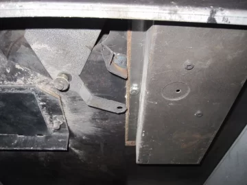

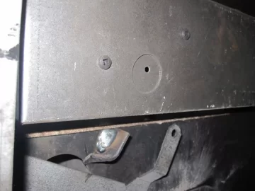

If you want to find out if this is the EBT, remove the ashpan and locate the EBT intake. This is about a 1" hole front and center on a rectangular box on the Summit A. Take a short piece of aluminum tape and tape over this hole. That will take the EBT out of the picture.If this ends up not being the issue, remove the tape.

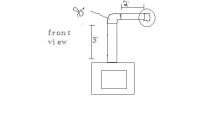

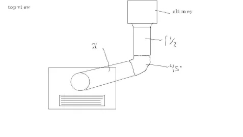

and mostly mapleThe wood 2-3 years old .multiple size split .When this happens,I reload on the bed of coal and the thermometer is in the 250-300f zone.I wait a bit til it goes up to around 850 then shut the air control and the secondary starts(blueish flame).It seem to idle there but all of a sudden it going up and up .Last night 1300f.Pretty sure its too high. I'm using a SBI double wall thermometer
not the best drawing but give you a idea

How tall is the chimney on this stove, (not the connecting stove pipe).?
no there not stove top temps.I will get one tomorrow night for sure and try to figure out what I'm doing wrong this year.For the height is 19'.The only thing I don't get is that I didnt have any issues last year.The SBI thermometer was installed this fall and I'm starting to thing that the thermometer is running my stove.I should take this tool for reference only

Bingo. Based on what we know so far I don't think this is a draft issue. A 19ft chimney with 2 90's isn't going to overdraft. The stove needs to be turned down much sooner after a reload and that ash trap door needs to close tightly.

this hole here youre talking about?

Yes. The EBT is closed in those photos.
