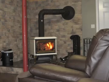

Too much draft PACIFIC ENERGY SUMMIT overfire?
This is a sped up version of the EBT operating.
still no change 800f and i can tell you its getting real warm here ;lol

There is a chance that the thermometer is wildly inaccurate or that temps are increasing due to the double 90 turn in the flue path slowing down the flue gases. Is there a generous uphill pitch on the horizontal section toward the chimney? Do you have a stove top thermometer as well?
i wouldnt say generous but theres a uphill pitch.No no stove top thermometer but will get one tomorrow night after work.1 90 deg and 1 45 deg toward the chimney
What is that under the stove? Is there supposed to be an ashpan in there?
