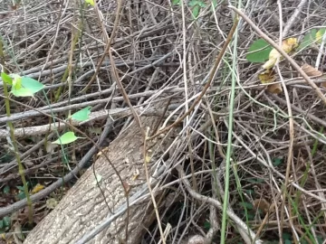

While i was out back today trying to get to a downed black locust that fell about 2 years ago, seeing how it was on the ground, i got creative and used my small floor jack and got it off the ground and put some old punky logs under one end so that it wouldnt pinch my saw when i cut it up. It got me to thinking of what other folks use to move logs, raise logs, etc...
Here is a picture of what i was cutting up, i still have about 30 ft left to get to and cut up. But it is a tangle of brush and thorns....at least i managed to get around 20 ft of it.

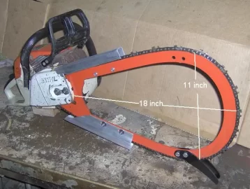

I have one of these......and while I don't use it very much it works great for logs that are of smaller diameter (8" to 16") and laying on the ground, even if they are in a position to pinch the bar. Bow bars were (and I believe with some still are) very popular in the South, but never really caught on up North here. This isn't a pic of my saw, just a pic I pulled off of the internet. But if you do lots of blowdown cutting of trees in precarious situations, this bar is hard to get pinched........very hard if you know how to use it.......

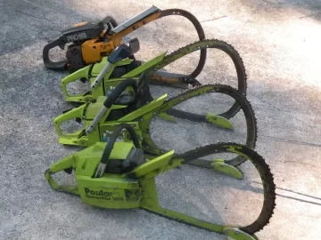

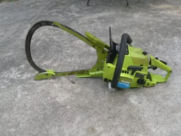

Shortly after Dad bought his Poulan 3400 in spring '81 I still remember his response to my request wanting a bow installed on it......
"HELL NO!! " ;lol
At the time they were still used quite often in the pulpwood industry down South.Said to work great going through those stacks of poles.... Maybe 1-2 times a year I'll see one on Ebay,in good shape they seem to bring $250 to 400.The same basic saw w/o bow was only $250-300 new 30 yrs ago!!! Unbelievable.

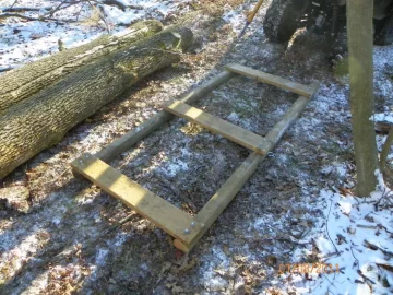

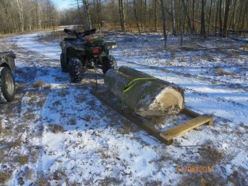

If you want to haul out the whole log, then a dray makes it very easy and keeps the log from getting dirt in the bark which will dull your chain super fast.

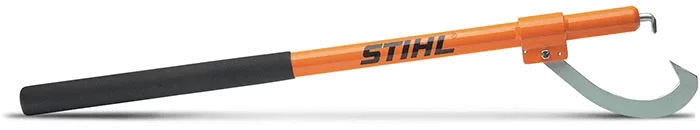

Most times when a tree drops there will be one or two places at least where you can cut the log. Of course you have to know how to cut to avoid pinching the saw but it is easy. When we do this, I'll simply cut a couple limbs or at least short pieces of limbs and place 2, 3 or 4 spaced along the log. Then using the cant hook:
[Hearth.com] Tools for getting wood.....
Roll the log onto those branches and now you can cut the log without hitting dirt with the chain. Another tool you can sometimes use to help roll a log is the hookaroon:
