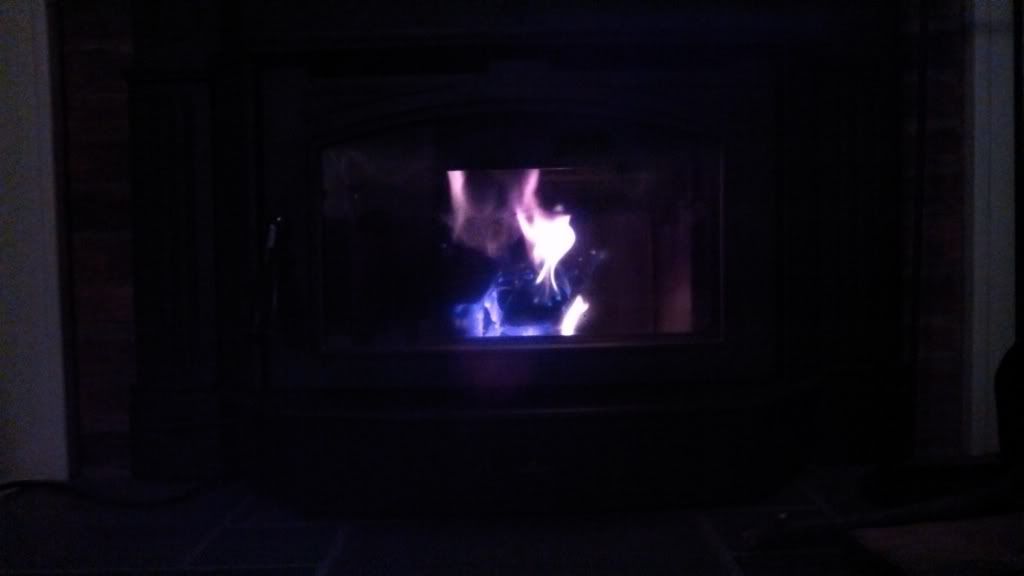

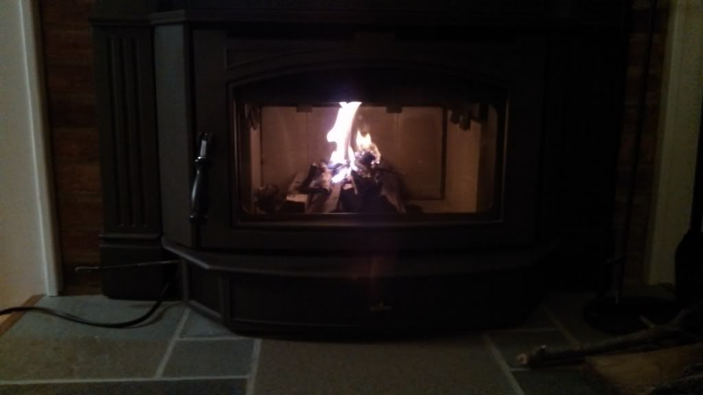

Did my third break in fire so went bigger. Decided being the temp outside was 46f that I would do a top down. Put a very small piece of supercedar on top of the kindling and lit her up. Never had to crack the door this time, maybe because top down created a better draft? First pic is at 5 minutes in, really no visible smoke

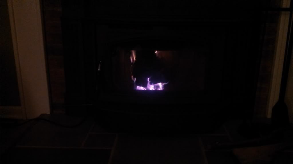

12 minutes in

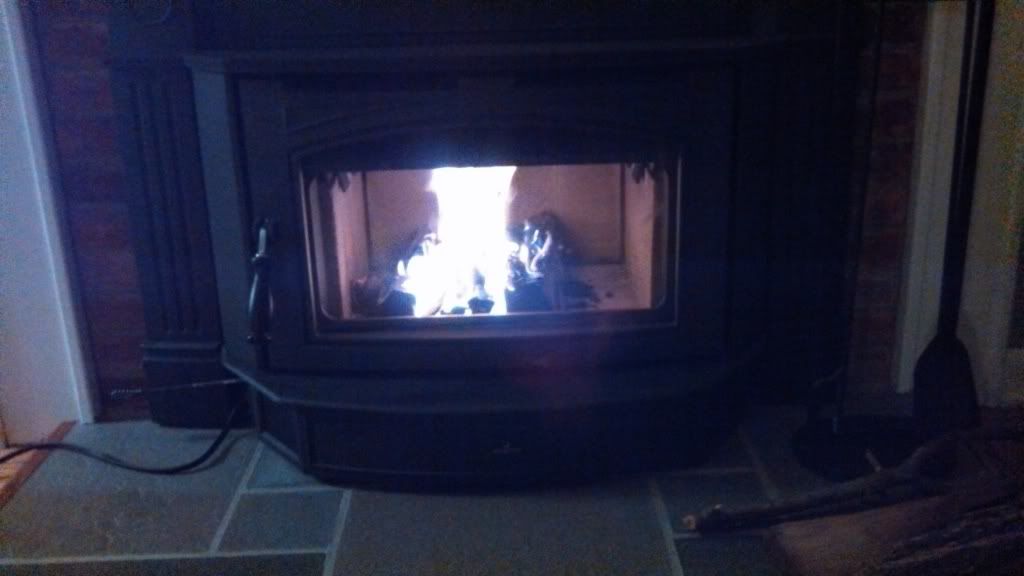

20 minutes in, air still all the way open

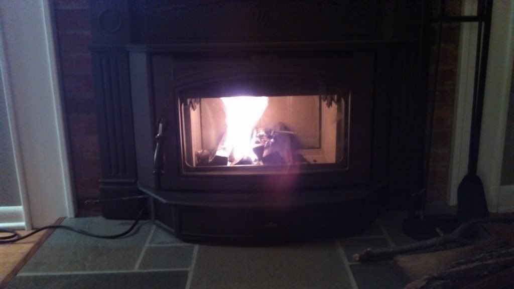

30 minutes in, made first air adjustment

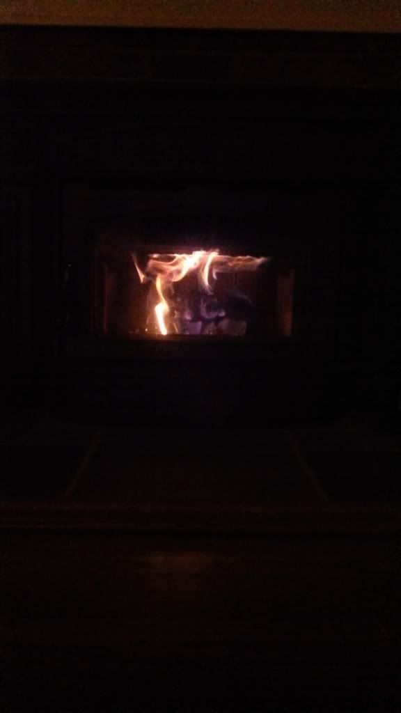

Air almost completely closed

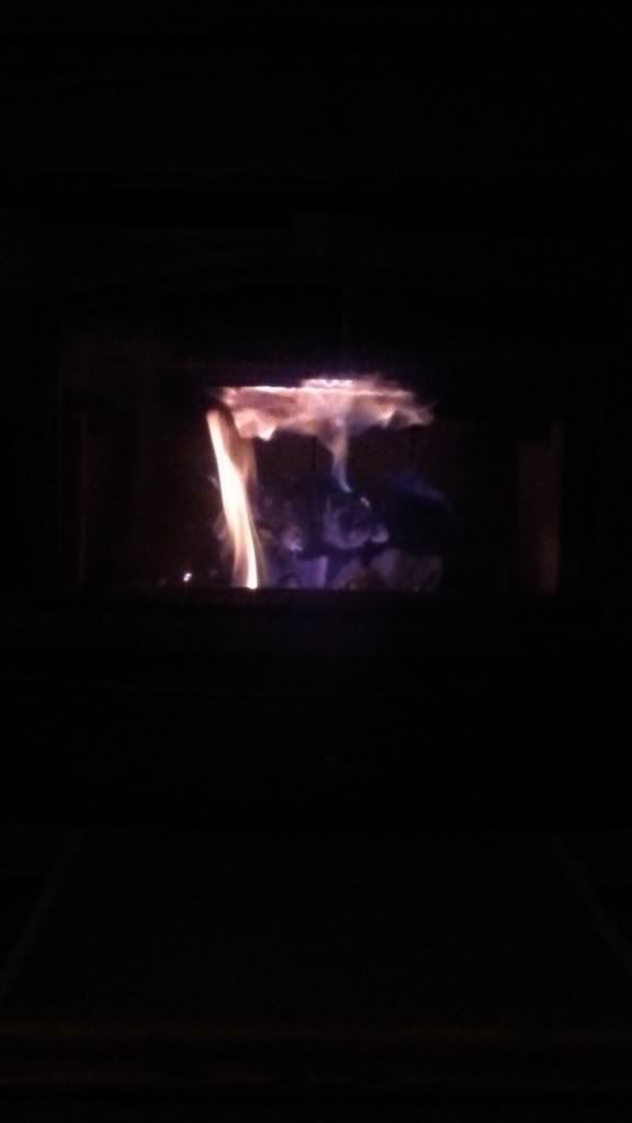

Air completely closed
Thats looks really good with outside temps not being real cold and not having the firebox full.
Your wood must be really dry.
Good Job. Nice Stove.
that's sass split last March, about 18% moisture. 4 small splits gave me usable heat for 4 hours . Fan on auto kicked on it 35 minutes. Was able to close air off and still got awesome secondaries firing. Think I'm gonna love this insert
video is about an hour and a half in, great secondaries and good heat output for the size load. the fan noise you hear is a box fan i have set up to push the smell of the paint burning off out the windows, its not the blower on the insert
I'm a huge fan of the top down start. As you've noticed, any smoke from the wood catching below is burned in the fire above. No smoke means no cranky neighbors and less cresote to lose sleep over.

Couldn't believe how fast it took off, having 3 year seasoned wood surely helps also.
