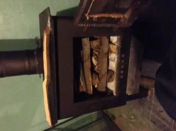

Here is how I have been building a fire lately. Seems to take off well and easy to add fuel without smothering. Loaded her up with maple tonight.

I usually stand the stove up after loading. ;lol
Turn the phone the other way.

I am using the wife's iPad. I had it held upright. I don't know why it keeps doing that. I'm not exactly the most tech minded person. I apologize. Lol.
tipping the stove over does make for fuller firebox though. Hell to add fuel To. Lol.
Might be handy for cleaning out the ashes....
