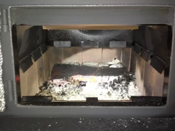

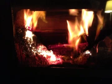

Well it worked fine for me, though I have nothing to compare it to. It's 75 in the living room and 71 in the bedroom hallway. Time for bed!
Reactions: n3pro
Last night @ 9:46pm (creosoted up front door was from me trying to burn green wood on previous wood fire attempt and dampening it down because I got the new stove and couldn't help it.)
Wood is labeled as "dry" from a coworker. He's a wood nut, but not Hearth.com wood nut in terms of having X # of years dry stuff. Certainly felt, sounded, acted like dry wood but not sure how old it is. Older than my 5mo old stuff for sure, haha.

When I went to bed, bimetal thermostat was turned down 95% of the way.
7:40am EST still putting out heat, but close to falling out of active zone. After taking this pic I turned up the bimetal thermostal and CAT probe climbed a bit, no smell outside:
