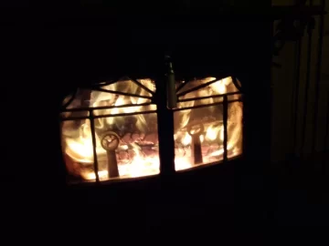

Splits rolling on the glass has never been a problem with the andirons. And besides its ceramic... Tougher than it looks.
East west fire show... 5 minutes ago....
Are those circular posts sticking up the andirons mentioned up above? I have never seen that before, wish my stove had that!
