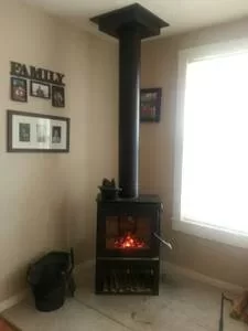

I've got 1100 in my 17vl with duraplus piping. Done it myself though. Pay no attention to the bare durock, I'm about to finish the hearth

Figure at least a grand for the flue double wall inside transitioned to triple at ceiling on out If you buy one of those pre-made hearth pads they can run up to $600
Make your own about a 1/3
