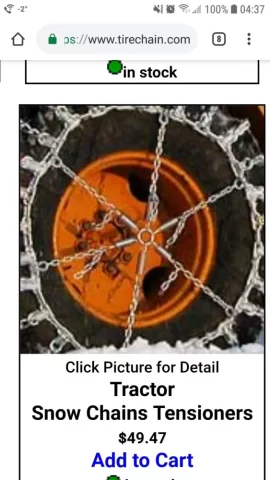

Does it matter that the chains aren't perfectly centered around the wheel? Do all of my springs need to have equal tension? The only chains to include instructions are those for my truck. None of the tractor chains came with anything. I would be real screwed if I hadn't called ahead of time to make sure I ordered the right thing. The gentleman on the phone suggested I get the load binder, without which I would not have gotten those tensioners on.

Here’s how I’ve been tensioning, I threw the stupid tensioning chain that came with these springs in the trash after two uses.
I own and race sailboats, and this is the knot I use for all of my cover ties, so I can tie it darn quick. It has a 2:1 purchase, and comes undone with a simple pull of the pigtail.
