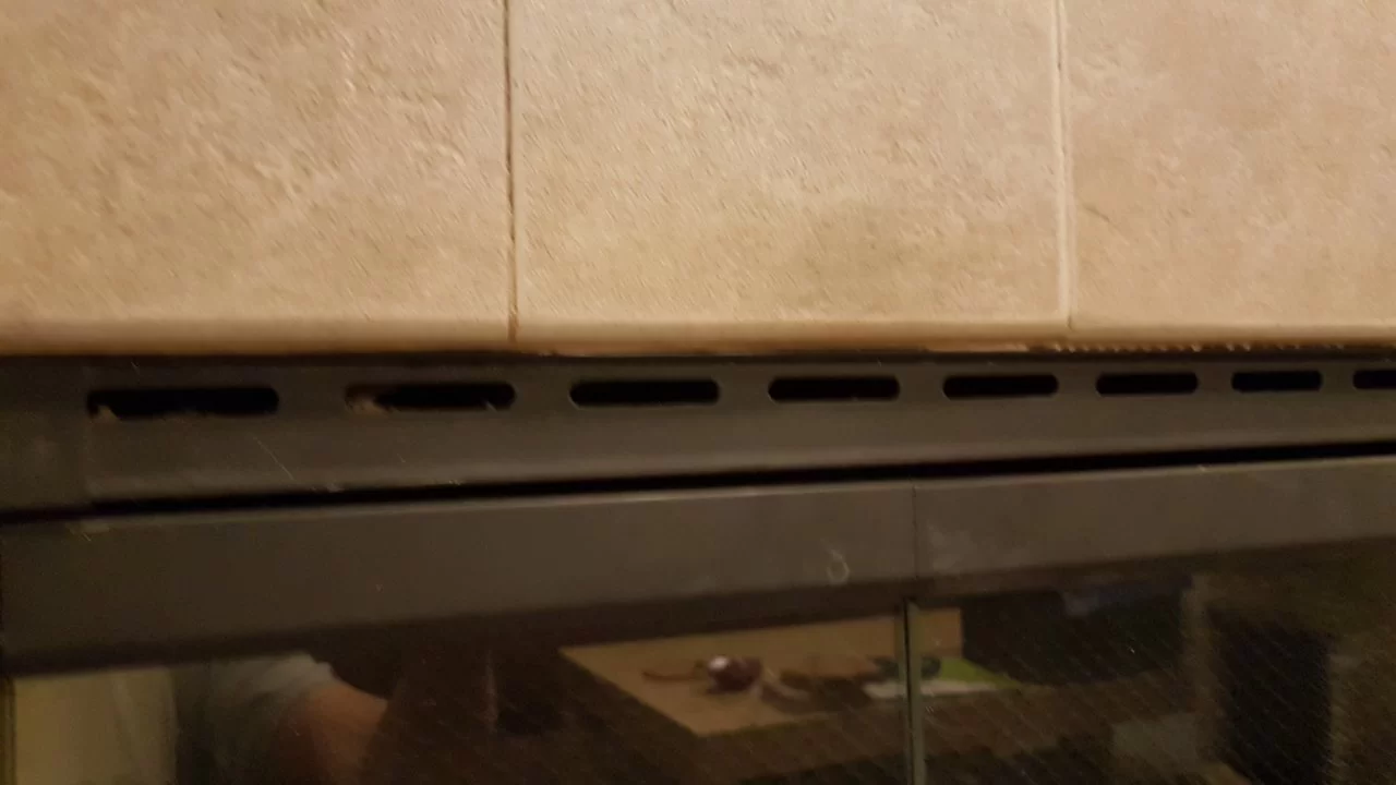

On the top [edited original that mistakenly said bottom] of the glass enclosure there's air vents, which I assume pull air in. Otherwise there are no other openings or intakes other than leaving the glass door open.
On the bottom of the glass enclosure there's air vents, which I assume pull air in. Otherwise there are no other openings or intakes other than leaving the glass door open.

Also - I mentioned above there were vents on the bottom of the fireplace frame. I was mistaken, they are actually at the top.
