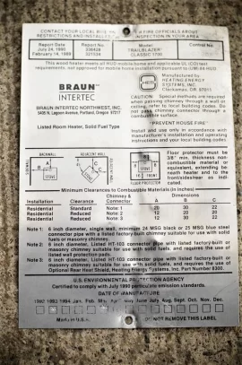

I have a trailblazer 1700 stove from the 1996. Redesigning the room and hearth. I’m unable to locate a manual for this stove so if anyone has one please let me know. Can I design a heart that is level/flush with ground? I prefer this if possible. How big would it need to be?
