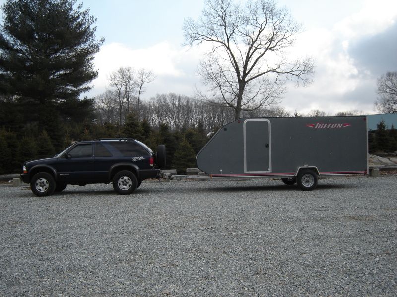

This trailer is a '97. I bought it used from a friend in '02. It has 18.5" tires and has seen countless high speed trips to northern Maine. I've replaced several sets of tires, but it still has the original bearings.
[Hearth.com] Trailer leaf vs tortion ?

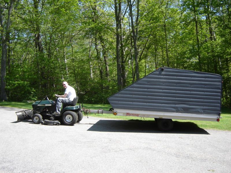

It begain riding a bit rougher in '11 and I noticed the axel stubs beginning to sag. It's a 2K axel but sits all years long with 2 650 lb machines in it. Right now it's my lawn shed, because I upgraded to this:
I don't tow with the ZR2's anymore, the Duramax does.
