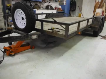

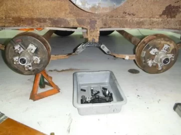

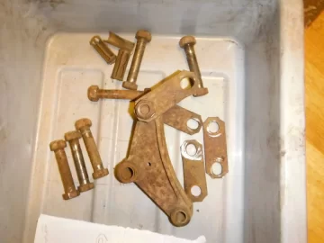

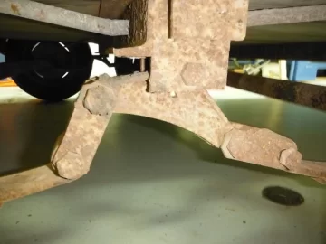

Decided to check the suspension.
Jack stands on one side of the axles & trailer.
Impact wrench amazingly took the bolts out.
Glad I did.
Bolts worn, bushings all but gone.
Bolt holes for the double axle suspension hangers are eggs shaped.
back to sixrobbles again tomorrow.

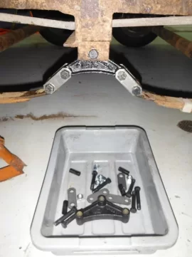

Cost $$ wasn't so bad , $87 did both sides.
Didn't get the fancy ones with grease zerks in the bolts.
I figure these lasted 16 years & didn't fall apart.
[Hearth.com] Trailer suspension [Hearth.com] Trailer suspension

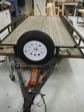

I consider it usable now. Bearings, brakes , spare tire, lights, suspension & registration done.
Just over $300 so far.
Plus I owe the wife diner for getting the registration problems ironed out. :)
Eventually I'll get the wood replaced, attach a ramp, some paint maybe & mount the spare on the front somewhere.

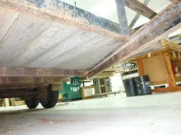

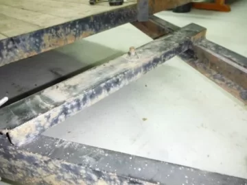

Nice looking trailer Dave, is the frame box or open? The reason I ask is my bros in law bought one last year looked good ,fresh paint , box frame, first big load frame broke just in front of the deck, box frame rusted from the inside out. Lucky he never made it out of the driveway.
I hate torsion axles. Had them on one trailer and it sucked to use on anything but nearly flat.
I love the torsion axles on my log trailer......makes getting in and out of uneven ground easier IMO......

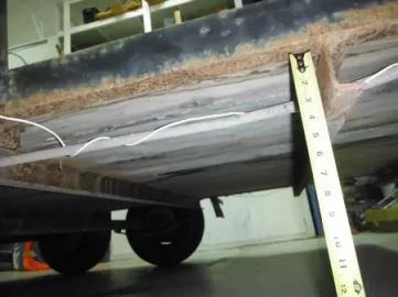

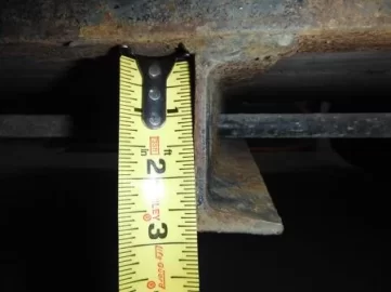

Nothing boxed in.
2" angle bed railing.
3" X 2" angle iron bed frame
4" channel tongue
3" channel beams under the bed
Everything I've banged on with a hammer seems
solid & the rust appears to be superficial surface rust.
To me it could use a sand blasting & a paint job to stop the rust & make it last many years.
