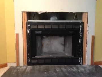

This is what I got to play with. It's a noise popper when you got a fire going. :)
Ill have to check out the free standing option.

Is it okay if I were to bump out the corner 76" wide x 12" depth x 52" height? Would that look goofy?
Also, if that were possible, the front 12 inches of the firebox would be encloved in the 52" space and the remaining 14" would sit in chase opening. Would there be any clearance issues with that?
I forgot to mention that the purpose of bumping it out is to try and fit a Kozy Heat z42.
Thanks.
You would have raise the header height so that the flue still has the proper clearance, but that's doable.
