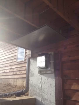

How close are the vent caps for your fireplaces? Can you take a pic & post it here?

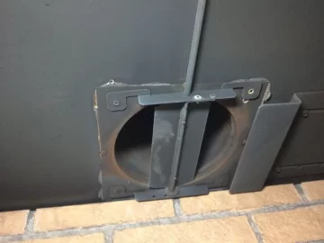

Yes, but I'm the customer and would not know if they are. Here is a picture of both. Sorry, I'm not trying to be controller here, I just see my dealer throwing parts at this thing and I know better at my age that something is stopping a continuous pilot out or stopping it from staying on. I uploaded a picture of the restrictor.
Here is a picture of the outside venting. This basement vented fireplace goes about maybe 6 feet up and does a 90 degree turn. Very gradual slope then maybe not quite 11 feet horizontal to outside under deck.

We are doing that now. I took the glass cover off to get a good picture of the restrictor plates and it appears like it could be drafty in there. Is that what your thinking? It blows the flame away from the probe and shuts off?
You know the flame hits the thermocouple and the flame probe pretty well. I tried blowing on it to see if a breeze would knock if off the flame probe and shut it off. It didn't. I blew on it pretty hard and the flame hardly lost contact with the thermocouple and flame probe.
That's an AWFUL long horizontal on a 6' rise. I'd be surprised if that's OK in the vent configuration in the install manual...

Is that restrictor on the OUTSIDE of the firebox? Are these B-Vent units? Like Dave, I'm not at all familiar with that model...
Sir, that restrictor is in the inside top of the unit.
Thanks!
its 5x8 direct vent.
has 2 restrictors, inlet and outlet
Hey, Dave. What's the manual say for allowable venting configurations? Can you acceptably run that far horizontal with a 6' rise? I can't open the manual .pdf here at work...
Hey, Dave. What's the manual say for allowable venting configurations? Can you acceptable run that far horizontal with a 6' rise? I can't open the manual .pdf here at work...
with one 90* at 6' vertical you can go up to 5' horizontal per manual found (broken link removed)
a little confusing though, it shows 3 90's as having a further horizontal allowance, wierd
Can't open it here, but he's running 11ft - more than DOUBLE the acceptable horizontal length...
