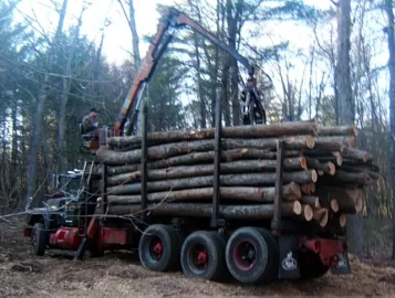

I gotta love the fact that I can get tree length wood delivered for $80 per cord or less. But I've never worked with tree length wood and I have one big question -- how heavy is a tree length piece of wood? Can a single person move it? I don't know what I'd do with a 5 cord pile of tree length logs if I couldn't budge any of them.
Yes, I got another reply from the guy and he says you're supposed to cut 16" pieces right off the pile of logs and then you can move those. Photo of tree length wood attached.

That's a nice looking load of wood. Not too big, so it should be a lot easier to cut and split.
You don't need anything too fancy to move the logs around, and you will need to do it. A long iron prybar works well. You can buy a peavey or a cant hook. Of the two, I would recommend the cant hook. The peavy has a long spike sticking out the bottom that tends to get in the way when you're trying to roll logs. Peaveys are made for moving floating logs around. I don't know why they still sell them, because nobody floats logs anymore, but they do.
One good way to cut logs in your yard is to roll them out away from the pile, then make cuts about 3/4 of the way through with your saw. Then roll the log over and finish making the cuts. This keeps your chain out of the dirt.
Cutting wood in your yard is the way to go if you have a way of disposing of all the sawdust and other crap that results from cutting and splitting. It's quite a pile--more than you might think.
G-rott is right about logs retaining moisture, and some species will start to rot if not cut and split fairly soon. I would aim to get it all cut, split and stacked before the snow flies, if possible. Then you'll have about 7 full cords of dry wood next season.
Hi Guys,
The simple solution to the moisture problem is to put a few tree lengths perpendicular to the direction the logs will be piled and pile the rest on top. That wood in the picture looks awful familiar to me, I think I have seen it before. :-)
Craig

Eric brought up some good points. Moving the logs and separating them out will be safer to cut. If cutting in a pile you have a very high chance your chainsaw will "kick back" at you. Keep the upper front tip of your chainsaw bar away from other wood when cutting. Make sure you think ahead when cutting and dont make it a race! Take your time cutting and always think about what your doing. Dont let your self get tired and take a good amount of breaks. Spreading out the logs and cutting most of the way through on the ground is the way to go, as you get better at cutting like this you will be able the cut over 95% of the way through the logs and when you move them they will just finish breaking at the cut. I wouldnt store logs too long on the ground so just take your time as you get them cut up and do a little at a time. Dont for get your P.P.E. personal protective equipment
Definately put the first two logs like MA logger says..makes moving them around easier and cures the moisture issue...Also makes it easier on the back...There is alot of sawdust...you save on buying mulch for the greenery...Some neighbors might not like the saw...If you can cut when it is cold, their windows are closed....The canthook is great tool where the saw goes that goes.
