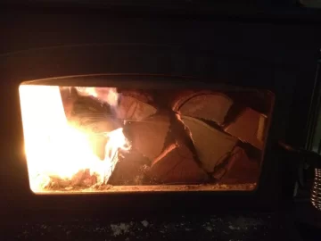

Here is the reload with coals raked all the way to the left
Since there were no coals on the right side it made loading and
packing easier. This is with the primary air fully out

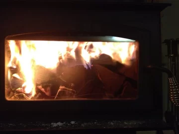

The left side here is in full combustion and
the secondaries are burning above. The primary air
is almost completely closed at this point

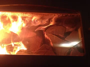

The primary air is closed completely and the
right side is burning from top down from the secondary
flames on the right.
[Hearth.com] Tried a different reload - Photos
This has produced a longer burn time for me
at a relatively high temperature.

Nice...how long was it between picture one and picture two when the secondaries got going a and you cut the air?Sometimes I wait to late thinking all the wood needs to be charred to cut the air. Again, you need very dry seasoned wood for this...
It was about ten minutes between photo 1 and photo 2. Photo 2 was taken when the primary air was out only 1/4". Another 5-7minutes to completely close the primary air. Just gradually reduce the primary air. Sitting on the floor with a cup of coffee makes it easier.
