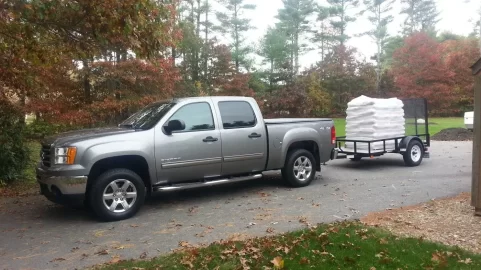

Get both! Actually, I have a truck for lots of reasons but I won't put a ton in my 1500 (payload rating is about 1700 lbs.). My trailer is rated up to about 2500 lbs (GVWR of 3000 minus trailer weight of 500). In Massachusetts, trailer brakes are not required until you exceed 3000 combined.

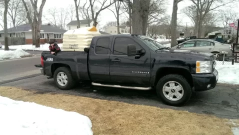

I've got a Dodge Cummins 4x4 dually and a triple axle trailer. I get my pellets delivered.
I'd like a small trailer too, but it would just take up space in front of the garage. So I go this route:

really? your truck won't hold ton in the back?
