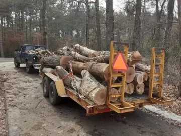

That must be a pretty serious tandem, unless you're drying the wood before hauling, or going after softwoods. Figure on roughly 5000 lb. (+/- 15%) per cord green, for most good hardwoods worth fetching, and a payload around 70% of GTWR. You'd need a 15,000 lb. GTWR to haul 2 - 3 cords of most good hardwoods, which is a pretty serious beast of a trailer, not to mention some means on-site to do the loading (think log stacking).I have a heavy 3/4 ton that will carry a cord. I also have a 5x8 trailer that will carry ~1500 lbs. The truck is my heavy hauler and the trailer is used for smaller runs. I have a tandem trailer to get going and that should increase the wood haulage to 2-3 cord per trip.

I’ve hauled a lot of dead ash on my 20ft trailer with 5000lb axles . Usually space is an issues with ash as I use side post to stack higher . In the last year or so I’ve hauled quit a bit of green hickory and oak . Big difference in weight . Don’t need the side post as weight is a big factor .That must be a pretty serious tandem, unless you're drying the wood before hauling, or going after softwoods. Figure on roughly 5000 lb. (+/- 15%) per cord green, for most good hardwoods worth fetching, and a payload around 70% of GTWR. You'd need a 15,000 lb. GTWR to haul 2 - 3 cords of most good hardwoods, which is a pretty serious beast of a trailer, not to mention some means on-site to do the loading (think log stacking).
I usually figure about 1.0 - 1.5 cords per trip, in my tandem with 3500 lb. axles. It's always an issue of weight, way before space.

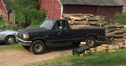

Fresh felled oak and hickory run 5000 - 5500 lb. per cord, ash runs 4500. Assuming a round 5000 lb. per cord, then you're at 5000 lb. in the bed + another 1500 - 2000 lb. tongue weight on the hitch. Must make your 3/4 ton truck squat pretty hard to have that much weight on the rear.I put a card on the truck and about 2 cord on the trailer.
The truck takes it pretty well.Fresh felled oak and hickory run 5000 - 5500 lb. per cord, ash runs 4500. Assuming a round 5000 lb. per cord, then you're at 5000 lb. in the bed + another 1500 - 2000 lb. tongue weight on the hitch. Must make your 3/4 ton truck squat pretty hard to have that much weight on the rear.

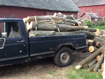

The first two loads are sopping wet maple and the one with the trailer is oak. I ran out of wood or I would have had more on the truck.
If you look at the second picture, you will see that a lot of the logs ar 12 footers.
