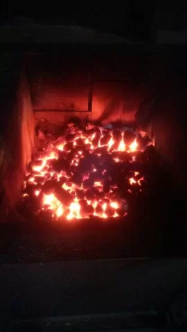

Trying Coal for the first time today.
Lcback
Feb 21, 2016
364
Pennsylvania
So I used about 1.5 cords this year and got into the wood I bought last winter. As always it was still wet 26% and it just wouldn't burn right. Call me spoiled seasoned or else now I guess. So I went to tractor supply and bought a few bags of anthracite nut coal to try in this most recent cold spell.
So far it seems pretty good. Tough to get started and a little spendy but it beats burning my wood before it's prime and filling the chimney with crap.
Bagged it's $300 a ton. So I'd take that any day over the $250 a cord price here for "seasoned" cherry and locust.
I don't quite know what I'm doing yet. But it looks like it's burning to me. [Hearth.com] Trying Coal for the first time today.

I will have to give this a shot. Getting a fire started with this stuff is miserable. I got it going the first day with a chimney of lump charcoal. I didn't have any briquettes on hand. I let the fire go out overnight. That was dumb, but I was hoping to save some fuel. Next day I couldn't get that coal going to save my life.
Sent from my SAMSUNG-SGH-I537 using Tapatalk
I use charcoal too but a much simpler method. I break up charcoalbricketts with a hammer to about rice coal size. Then place the charcoal on the grate where the unburned coal meets the ashes and light with a soldering torch. The whole process is just a few minutes. Been doing this for 15 years. Any kind of charcoal works ,no lighter fluid necessary.
I've always started Anthracite Nut with just paper and kindling. (Amish built stoves) If you sprinkle some fresh coal over the top before lighting, then keep the flames ripping up through it, not a lazy fire, it should take right off. No section of grate can remain open that allows air leaks up through grate, even if you have to cover it with coal. The key is getting all the air up through the fire where the coal is. It will spread across grate with lots of air. As soon as it starts, sprinkle more on top until you can cover it. Coal fire should be established in 15 minutes.
The picture of your fire looks like a very rough fire. If you cover it fully with coal so it is the same thickness, then set air to about 1/4 you should get blue flames on top and a glowing mass under it. The more air, the more blue flames. I'm not sure what your stove uses for secondary air, but as oxygen comes up through the fire bed, oxygen is consumed and coal gas that emits from fresh coal ignites on top when given just a little air. Some stoves will have a secondary adjustment, others have a predetermined leak around grate. You don't open the top much if you have a secondary inlet. Too much allows cool air above the fire to slip up the chimney slowing draft. Once you get the hang of it, you'll appreciate the long steady burn with much less work. If it has a banking plate across front, fill it right to the top of the plate. Most companies sell in bulk with your own containers for closer to $200 / ton.
