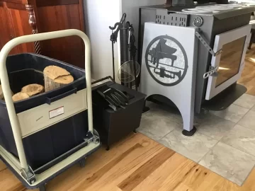

This is current room the stove will be placed:
We really love the look of the Progress and the massive chest of soapstone tiles it has for a lasting radiant residual effects. One of the big differences is side load vs front load. I have always had front load, but this defiant stove is the first one with glass! I can make the side load work but with the location of the stove it will always be approached at a slight angle due to the brick surround. I will never be able to directly look or load in the firebox from the side, always with a slight angle. I am concerned about the ergonomics of doing that with heavier 20" oak splits. Less so with ash pan operations but same situation, angular approach position. This picture was during an attempt to organize the area around the stove, but honestly can represent the space in some real world conditions.
The Ideal Steel is ergonomically more friendly, its looks might be construed as trendy but I think it is still very tasteful. It appears that both stoves can perform the way we want them to and both are a huge improvement from our current one!
Has anyone had both? Anyone worked with a Progress with a similar approach as I am describing?

That’s a large home. The IS is larger and a straight in front loader. I would prefer the IS. Soapstone is not a benefit in my experience. Well, other than looks, it looks great.

I also am looking at both stoves for our future. If I understand the options the PH can be ordered with a right vs left side loading door. It looks like you have room on the right side although I know pictures can be deceiving. what Is the current wait time for either stove?

I am a huge fan of my PH. Specifically:
The looks. The soap stone is an eye catcher and radiates heat perfectly.
The side load door. Never any ash spill, clean up when loading wood. Can get fire box nice and full. No regrets at all.
Reactions: kiowa
Jan 20, 2019
39
Missouri
Big fan of my IS. Handles my huge open area, (about same size as your area) and with temps last night at -8f, and a high so far of 7, keeping my main living area up near 72-73 with loading every 7-8 hours with big rounds that burn very nice. Modern construction well insulated home, I love the huge front loading door that can handle big 20” long rounds without splitting.
Turn your ceiling fan on reverse, and that heat will flow all over your area. Also, do consider custom art, make it a centerpiece. I like the soapstone for providing longer overnight heat warmth, when burning hotter, sure it is not as important. But when I go to bed, the side soapstone with the stove cruising along is 180’+ when I am up 8-9 hours later, side stones are still 120-130 with stove temps of several hundred.
