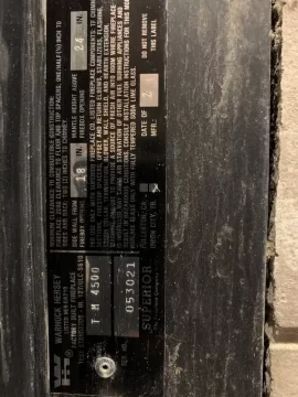

My Wife and I decided we wanted to put a wood insert in here. Currently it's a set of gas logs we've never even used (propane not hooked up). So, we want to fill the space with something that will be functional and look nice. We want something enamel like the Hearthstone Clydsedale, or Regency Hi2450, etc..
The opening from the outside is about 45"X29"
The inside measurements are: 36"W at front 28"W at back, 25" high, and 23" deep.
The issue is that the stone is not flush on either side of the fireplace. It is angled. So, I think it will look awkward if the trim overhangs. Maybe it would look weird recessed in the stone? So, I could buy one close to the opening size and trim the stone with a grinder.. I'm not even sure... I can't find photos of any other fireplace like this online, so I'm having trouble brainstorming ideas.

Ok that is a zero clearance fireplace. Which means it is very unlikely that an insert can be installed in it.
Well...that really bursts my bubble. The guy at the fireplace shop didn't seem concerned about it when I showed him the photos. I assumed if an open flame from gas could be safe in there, an insert where the fire is completely contained in even another layer - it would be totally safe. Obviously I dont want to do anything unsafe though. I do not see any obvious combustibles in sight looking around with a flashlight, etc..
Find the id plate for the fireplace. It should be somewhere on the lip around the edge. From there we can find the manual to see if inserts are allowed. But most do not

Also - I should say, I would be totally willing to put a pellet insert inside instead - if that is possible.
Well no need to even look up the manual. That label clearly says only for use with superior fireplace listed components. That doesn't include inserts of any kind. And if you look up the manual it clearly says no inserts

We don't know if an insert would be unsafe or not. No one does because it was never tested. What we do know is that the manufacturer of your fireplace very clearly states in the manual that you cannot install an insert in that fireplace. That means no matter what the insert manufacturer says there is no way you can do a code compliant install of any insert in that fireplace. If you are assuming any risks involved because insurance will most likely not cover a claim involving it.
The right thing to do would be to either remove what's there and replace it with a high efficiency zero clearance fireplace or leave that as is and install a stove elsewhere for heat. I would recommend having a full inspection done of that fireplace before using it though.

It absolutely is a wood urning fireplace. Just look up the manual.
Putting in a full masonry fireplace will most likely cost you in excess of $20000. And still give you not much of any heat.

Read the manual. They allow gas logs not inserts. Putting an insert in is totally different from simply burning wood in it. These fireplaces were never meant to support the weight of an insert. They are also only meant for occasional fires where most inserts will be run for long extended periods of time increasing heat transfer. But to be clear I never said it would be unsafe. I said it may be we don't know because no one tested it. And that it would be a clear code violation
They pretty much all have knockouts to run a gas line in for a gas log set. And most manuals allow that as well.
