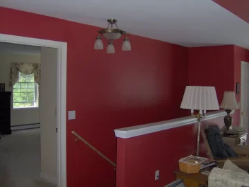

Here is my solution:
The upper portion of the the air distribution system
[Hearth.com] Trying to move air through the house, Fail !!! with fans
The lower portion.
It is powered by the stoves convection blower system which is set to follow the heat range.
Cold air gets sucked into the stove below where the hot air is pushed out of the heat exchanger, the warm air rises and exits the stove room still rising. It continues to rise until it is blocked by the ceiling and spread out into the great room and such.
The cold air from upstairs falls down the stairs into the stove room.
See Ma no extra fans needed.
