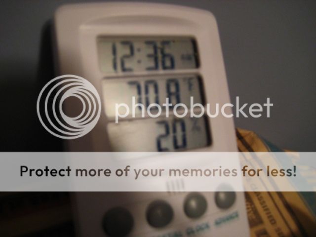

Okay, a picture is worth a thousand words. Temp in bedroom, stove at idle with LR ceiling fan on and two small fans pushing air down the hallway. Yes, the time is off because I didn't set it when I last changed the batteries - took first pic about 6:35 PM tonight.

Pictures taken after sun went down, and temp outside is 10F, no wind and cloud cover so temp has not fallen during test. I chose the BR because it has curtains over the windows (less heat loss). All rooms have new triple pane windows and new insulation, vapor barrier and 1/2" sheet rock installed this fall.
Edit at 8:13. The stove has shut itself down as it hasn't called for heat since turning on the fans (which it called for heat shortly after turning fans off). Scientific test? No, but anecdotal to my house that I can repeat all night long. During day stove is mostly shut down because of heat from sun in the room the thermostat is in - at that point bedrooms get down to 68-69.
