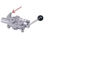

Please explain how to do it. I don't see it in the manual.
Loosen the outer, tighten the inner a little bit, and snug the outer back up. That did it on my splitter.

No protruding dohickey on mine like that :+(
that is not the valve on ours.glad to see they upgraded it.the old style is a POS.
...anyone know how to adjust this new style valve then?
No, but most splitters use generic components from only a few suppliers - See if you can find a manufacturer name and model on the valve - it's probably cast into it somewhere, and Google for it, probably will have a manual with directions on how to adjust.
