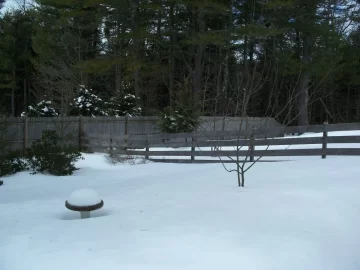

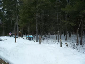

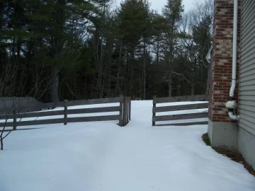

Ok, after years of dealing with tarps, etc....I am finally going to build my woodshed.
Had originally built the fence to keep the kiddies somewhat in the backyard, but now they are 10, 8 and 5, so the fence is a comin down. (Always hated it especially when mowing)
Have been thinking about this project for about a year now, and I am going to build as much of the woodshed as possible out of the remnants of the fence. I figure I have about 14 4X4's that are about 7 feet each, and 35-40 1 X 8's of cedar. This is going to be a kick arse shed.

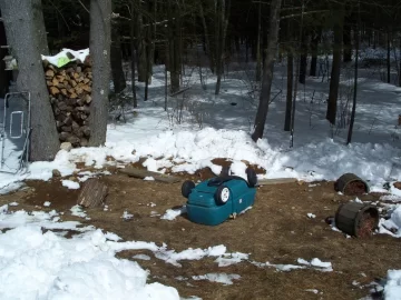

Some pics of this weeks progress, dismantle the fence and dig the footings. Actually got down about 30-32" for each one, so I was pretty pleased with that. (I figured my wife would have a fit if I left 6 open holes, so hence the planters and kids wagon to cover the holes)
I'm in North Central Massachusetts, and hard to believe that we still have this much freakin snow this time of year.
Will have to wait for the ground to thaw a bit so I can pull the 4 X 4's out of the soil, but I am on my way. (Checked a few last year, and no rot whatsoever)

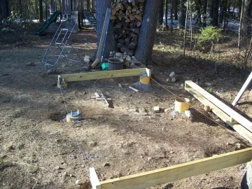

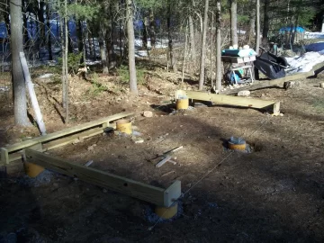

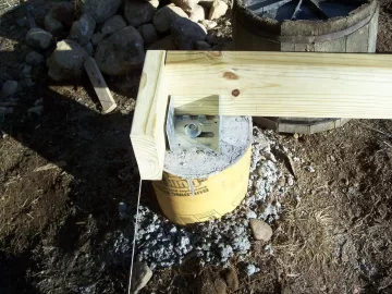

Got the 6 footings dug and poured over easter weekend....depths in the front are only 22-26" or so due to a plethura of roots, but was able to get the back 3 down to 28-34" or so. Used 8" tubes, but only managed to get 5 out of the 6 poured as my wife informed me Easter Dinner was at noon vs 1:00 as originally planned, lol. (Must have not had my clairvoyant device turned on that day)
Set 7" carriage bolts into the concrete, and then attached post ties to each footing. (I have a new found respect for builders as it was a majot PITA trying to get a.) the sona tubes level, and b.) the post ties square.
Got all but one of the 4 x 4 posts out of the frozen ground, so it looks I will be ready to build soon.

[Hearth.com] Turning a fence into a woodshed - my "green" woodsheld build
So I lined out each post using the old fashion string theory, lol. (was trying to use stuff I had on hand vs purchasing) Piers are basically 12' across and 6' front to back (Outside measurements)[Hearth.com] Turning a fence into a woodshed - my "green" woodsheld build
Still have one more pier to pour as I ran outt time on easter bunny day.

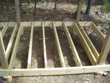

[Hearth.com] Turning a fence into a woodshed - my "green" woodsheld build I had some scrap 2 X 6 and was having a difficult time lining up the center of each post attachment, so I made a temporary L on each corner to find the proper place to put each post and bracket. (They are somewhat adjustable, but wanted to get them close as possible)
So, my plan is now have the woodshed portion of the shed to be 12 X 6, and then I am going to cantilever out a bit on each side storage of some garden tools, etc. (Roof will be 16 X 6, so I figure I'll have some overhand on each side.....still trying to work that piece out.)
In theory, I will have (2) 6 x 6 sections and I am planning on using 2 X 6 pressure treated for the joists on the floor. I was able to get the posts aligned in that each 2 X 6 joist near the piers will also rest on top of the concrete pier for added support) Yall think that 2 X 6's are ok if they are 16" on center, os should I go up to 2 X 8's? (This is going to be 2 year seasoned wood, so the weight will not be that of geen)

Dave looks good! You can save alot if don't build a floor and weight of the wood will not be a problem if you place pallets on the ground. I have a 2"x6" floor on my shelter and had to support the span at 6' plus support the ends with heavy beams because joist hangers can't take the weight. My joist hangers literally were ripping out from the weight of all the oak! I happened to have some 8"x8" PT beams kicking around and saved the day! If I were to build a shelter again I would keep the floor separate from the structure for this reason and save money in the process..

Thanks for the info Ray. I was thinking about no having a floor. and just going with the pallet method, but its a big slope from front too back. (Pics don't really do it justice) And also this is going to be within "eyesight" so its going to have to look "pretty" if you know what I mean. When all is said and done I am going to have some 4 X 4's left over, so if I need some extra support I can use those and maybe dig another footing or 2 as I have some sona tubes left over that are about 18-24 inches. Although this is going to be a woodshed, I am going to have a portion of it or garden tools and stuff, so I need to make it "purdy" for my significant other, lol.

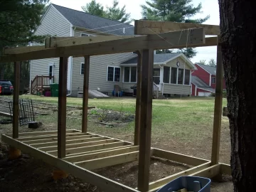

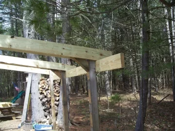

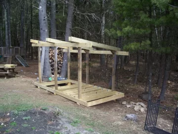

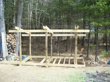

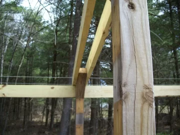

Made some progress over last weekend. Some pics.[Hearth.com] Turning a fence into a woodshed - my "green" woodsheld buildLink Removed[Hearth.com] Turning a fence into a woodshed - my "green" woodsheld build[Hearth.com] Turning a fence into a woodshed - my "green" woodsheld build[Hearth.com] Turning a fence into a woodshed - my "green" woodsheld build [Hearth.com] Turning a fence into a woodshed - my "green" woodsheld build

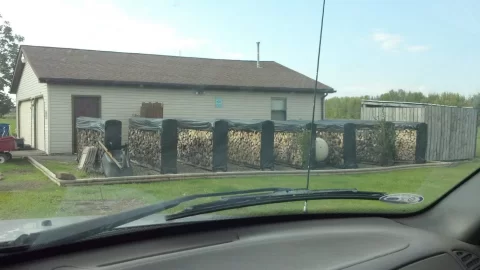

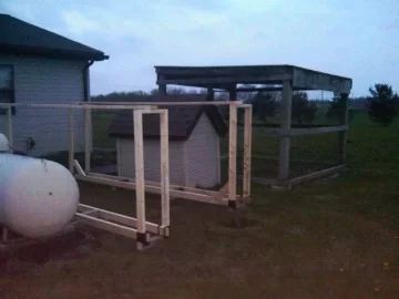

I took a dog kennel and turned it into a wood shed with my old wood from a horse fence.
Took an area that looked like this (without the 2 racks) and added 8 racks then sided shed/kennel
Repurposing wood or any item helps keep the memory around. IMO
