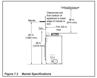

The installer is correct. A wood timber mantel would need to be at least 14" higher (min 46" vs 60"). If that is what's desired then follow the manual's guidance and it should be ok. One caveat with wood is that the timber mantel may check or split as the heat dries it out.

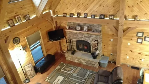

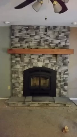

Here are some examples of wood mantels with new ZC fireplaces that may help you visualize the final look with a wood mantel. The last is a Northstar.
[Hearth.com] Type of mantel for Heat & Glo Northstar? [Hearth.com] Type of mantel for Heat & Glo Northstar? [Hearth.com] Type of mantel for Heat & Glo Northstar?

Yep that class of ZC require 60" of clearance - we ran into this with our 7100. The fireplace and hearth were already stone so we went with a stone mantel with stone corbels. I like the look of our wood mantel on the outdoor fireplace better, but we wanted our TV above the 7100 and there was no way I was going to hang it that high. I also like the peace of mind knowing that the stone slab mantel can get as hot as the 7100 wants to get it - no worries when I'm away.

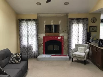

Well, after a couple of months of going back and forth with the company we purchased the fireplace from, we were finally able to get the contractor here this weekend to install the stone. Of course they sent an unfinished mantle which was supposed to be a dark brown and a stained hearth. So those are being reordered, but we finally have something enjoyable to look at.
We are going to do a couple of smaller fires to let the paint cure then let er rip. :)
