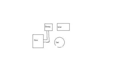

Here is a very bad sketch of the current setup
  • [Hearth.com] Type of material for for close call to hot water tank??? (For my parents..kinda an emergency)

Well, went over there today and they had ther HVAC guy lean some sheetrock (says fire proof or something on it) and I told them that I don't think that that was going to cut it. Actually, there is a steel column about 3 feet out, and with the existing chimney I can easily get some durock and just rest it between the column and chimney and that should be all that is needed. (They will only use the stove 1-2 times per year when the power goes out)
I was surprised that the HVAC just left some sheetrock between the stove and the hot water tank..There was paper backing on the board, so I wasn't that pleased that the HVAC guys would have said that this was ok. This is an older steel stove with single wall pipe. I went over with my mom on how to control the stove and soforth, and just told her to keep the temps below 400 until I can get the durock on there.
