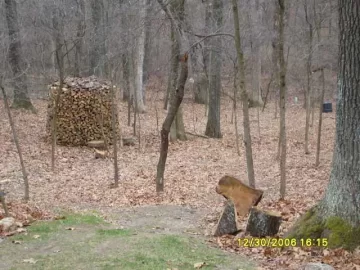

Here's my latest creation in movie and still. ;)

That's great work Mo, nice video too. I may just have to try one of those this season.
I'm curious though, is that a Missouri holz hausen (sp?)? It looks a little smaller than some of the ones I've seen around here ;-)
Holy chit ! Thats a monster pile brother , without the video it would of been hard to tell.
Do you let them sit to season for 1 or 2 years being in the trees and all ?

Spike, I'll let you know next year. ;)
Mo nice looking stack of wood. I was hoping for a Tarzan call from the top of the pile though.
Hey Mo, How do you remove pieces from that pile? It looks like you'll need a step-ladder to take pieces off the top. Is that going to be a PITA?

Yep, step ladder. No big deal. The PITA is getting the wood up the hill to the house.
I built this thing to consume ALL the wood I had from about 4 big oak trees. It got a bit taller than I had anticipated, but only by about a foot. This way, I only have one stack for next year. Hopefully the stuff in the middle will get dry. I think it will because there are so many really short pieces that it would have been an even bigger PITA to stack them.
The holz design really lends itself to a mix of wood sizes like I get from random tree service occurrences in my hood, and some of the twisted white oak and crap yard tree wood I sometimes have to cut really short due to tuff grain, crotches, and knots in order to split it by hand. I put all the really nice long stuff on the bottom perimeter, getting shorter as I go up. All the little stuff just gets thrown into the middle. Takes a bit of sorting, but I end up with one nice, symmetrical pile. Quite the conversation piece as well.
Really impressive holz Mo. How many cords do you estimate are in there?
It looks freakin' awesome! Any idea how long it took to build?
Nice stack Mo I might have to try that this year.
BG, Thanks. I estimate just under 3 cords.
WW, Thanks for the enthusiasm. It's hard to estimate total time of stacking, but I'd guess 6 to 8 hours x 2 people =~ 12 to 16 person hrs. Maybe an hour or two less. I did it piece meal so it took several months calendar time. I'd say it took longer for me than the times Todd has quoted in the past, even given his smaller HH. Given this one is a bit larger than his, it took me even more time. I tend to be very slow and methodical. I mean, hey, what's the hurry, right? This is wood burning related, so time goes out the window. ;)
EH, Thanks. I love this form. Looks great in the back yard, and that can be important in my neighborhood. Lots of silly whiners around here worried about their property values, or in some cases, just trying to feel important, or at least more important than Mo. Mrs. Mo Heat and I sometimes refer to the holz as a giant pine cone. To my eye, it sure beats the right angles of traditional rows for blending into the woods. Just seems more pleasant to view, somehow. It's important to try and build on level ground, though, and to start with a good foundation and long length lower courses. I'll have to finish my holz wiki entry soon. I've been putting that off too long.
Nice job Mo, yours is bigger than mine! ;-P
I may try to top you next spring. I'm thinking about 2 ea, oval holz about 12x5x6. I'd like to get 3 cords like yours in each but it's a pain when it's over 6' high and 8' across. I think an oval or rectangle one would work better for me. Stay tuned.
BTW, I'm 2/3 the way through one of my HH and so far all the wood is well seasoned, even the middle pieces.
Hi Todd,
I found it easier to keep the [inward] slope of all the lower splits when stacking the larger holz (10 x 10 x 8). That is, there was less gap between the outside ends and so it required less attention to deal with that little nuisance than when building my smaller holz (7 x 7 x 7).
I'm glad to hear the middle stuff dried well for you. I'm hoping that isn't an issue with this big holz next year. Since most of the stuff in the middle is shorter, some is really short, I'm not expecting trouble.
I never thought of varying the rounded perimeter shape from a circle. That will be interesting to view. Space is a big consideration at my house (I want it to 'look' small), so the cylinder gives me the best bang per foot print.
BTW: my little holz collapsed about two weeks before I started burning. No big deal, though. I had expected it for quite a while and was surprised it stood as long as it did. I built it on quite a slope and it started moving and bulging down the hill a few months after completion. On the bigger holz, I used some landscaping stones to try and defeat the somewhat milder slope I built it on, but it is still on a hill. We'll see how well it does. Next time, I think I'll dump some fill within the landscape stones and start out on a level surface. That is the first instruction of the holz directions I worked from. Step 1: DO NOT BUILD ON A HILL!

That is a nice looking wood pile. I thought one of the advantages of that type of pile was it dried the wood faster due to the chimney effect?
Craig
So far I haven't noticed that the wood drys faster in a HH than straight rows. I think the big advantage is the saved space. Those things hold alot of wood.

For me, the jury is still out on how fast wood dries in an HH, especially a big one, but it is amazing how much wood gets gobbled up making one of these things. I also love the way they look.
While your boots look rather smashing on you in the video, I'd recommend something a bit more sturdier if you hope to reach the summit. Clogs, maybe. BTW, great stack and great symmetry. Keep us posted on how it dries. And any ideas of how well an HH would work if you cut it down in size, maybe in half?

drewmo, I suspect the smaller the holz, the faster the drying. I size mine more for asthetics and how much wood I am trying to store. I attempted to get the whole of next year's burning into that one holz hausen.

I'll let you know how the drying goes. I can say that the smaller holz I built last April and am burning now is dried to about 20%. At 20% I get just a hint of hissing when I burn it. I like my wood at 15%, but that last 5% seems to take a lot longer than the first 5%. Still, 20% is what is widely recommended and it burns just fine with no trouble getting it started.
Mo Heat, how about PVC pipe with holes in it sticking up the center for more air movement ¿

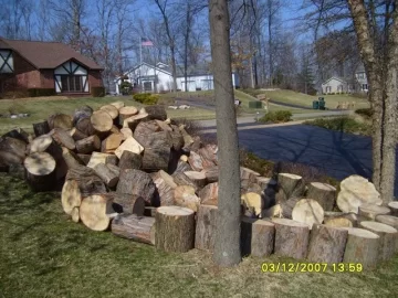

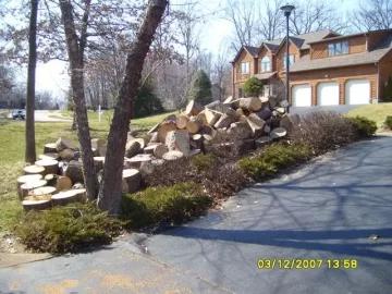

That might be worth a try if I had a piece laying around and pre-drilled. I made some home-made termite traps by drilling pvc and I had my fill of doing that. BTW: I just received a load of Maple (my first maple, ever) and am still deciding whether to build a third holz out back, or maybe do a row along the back property line as a sort of fence. Since this maple will probably be for the winter after next, I may need to do some other projects first.
Here's the maple I got from a tree service working in the hood last week. My luck seems to be changing after having a disasterous vacation the two weeks before that. Looks like about 1.5 cords that should make a third holz sometime before next winter, to be burned the winter after. Mrs. Mo Heat is starting to get pretty nervous about where this will all end...
