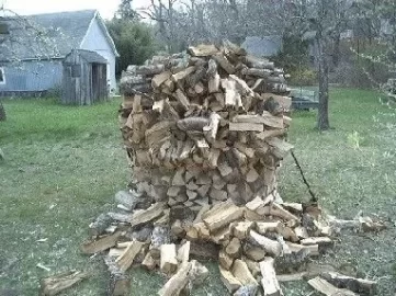

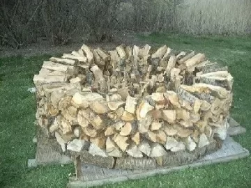

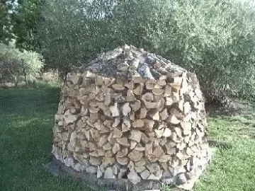

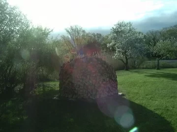

Here's are some shots of the blow out and a new small haufen... A couple of recommendations.
Keep the cant. If you lose it, it will blow out. The photos don't show it very well, but you need to maintain strong inward tip when laying the wood. If you are careful, you can place the right piece and not require any of the lateral 'cheaters'. The inner stack (upright) is tucked in against the outer ring.
The original (blown out) haufen looked awesome when completed. Over a few weeks, its top widened, settling out and down and eventually blew out. I hadn't kept the cant at the top.
Haufen with straight, long splits are a lot easier to build. These are apple and cherry cut 12"-14" and often bent or curved, making it tough to stack. Gnarlier pieces made up the center stack, but fruitwood doesn't grow straight like oak and it's a tough to make a haufen out of it. Uniform splits let you roll along.
The inner pile was stacked carefully (upright) on the second haufen. With the first, it was stacked upright most of the way to the top, then it was piled on randomly at the top to finish. I think that caused a side load as the pile settled which was not resisted because the cant on the outer ring wasn't there applying inward pressure.
I don't think the haufen shrinks as much to drying as settling (drying causes the settling). The cant pushes this movement inward to counter any bulging pressure of the settling inner stack.
These were built on a square of 4 pallets and the second on a square of 8' ties with ply scraps. It's tougher to stack one this small. It comes out great, but I won't make another under 10' square. It's too hard to stack - you can move a lot faster with a bigger one. It will also hold a whole mess of wood. When you get to filling the middle it's amazing what it holds and the scale really gets good when bigger than 8'. The second is a little over 2 cords. There was about 3 in the taller, larger first one.
